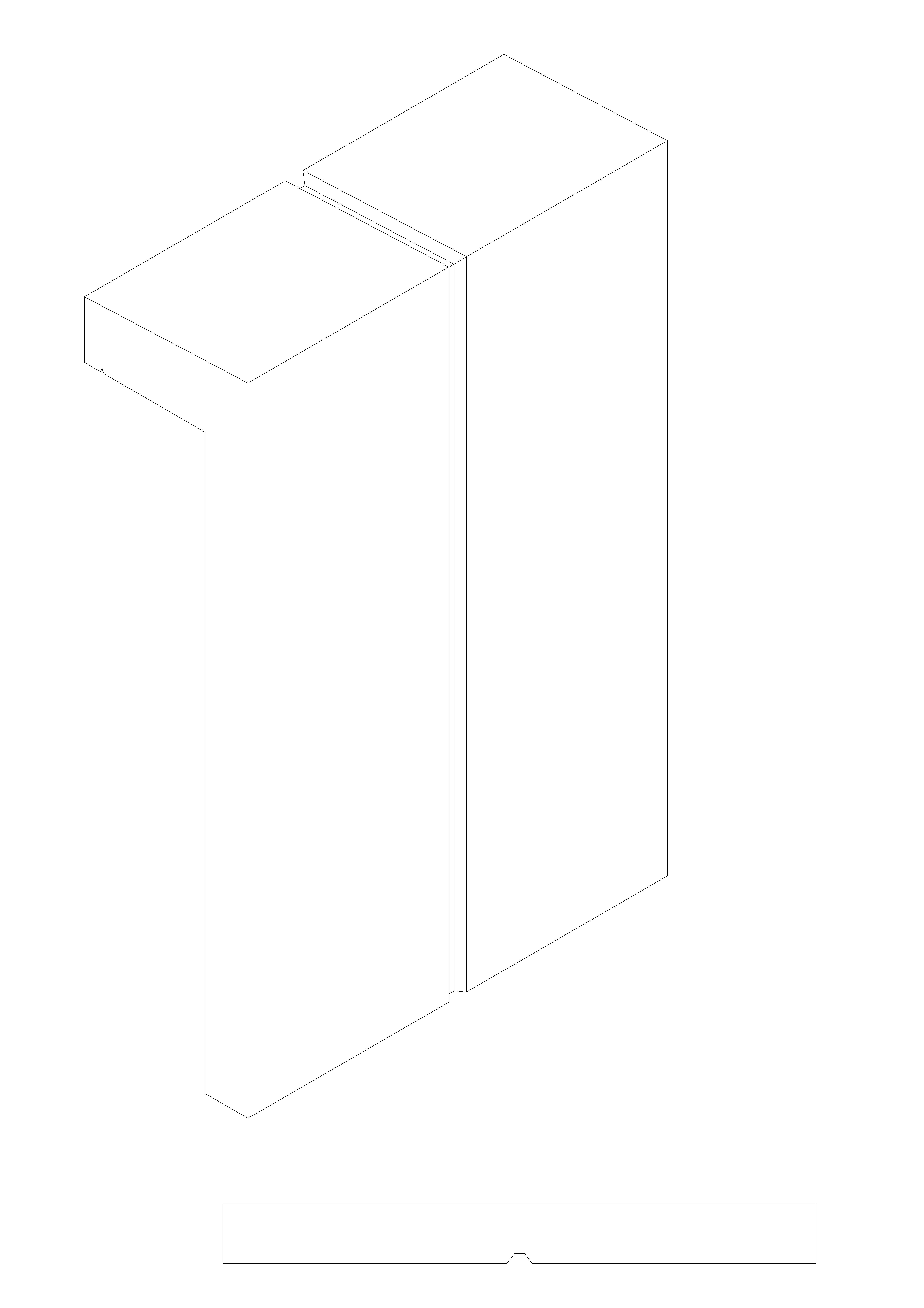

please help me how you can make the grove in precast panels at parapet copping
Wed, Jan 16, 2013 at 7:11:37 AM | Precast panels and vertical reveals
Wall reveal.  Read your HELP if you don't know how.
Wed, Jan 16, 2013 at 7:30:31 AM | Precast panels and vertical reveals
murtuza
Joined: Wed, Dec 12, 2012
3 Posts
THANKS FOR YOUR QUICK REPLY HERE IS MY ATTACHED FILE FOR REVIT
     I M WORKING IN PRECAST COMPANY WHICH IS DEALING WITH PRECAST PANELS THIS IS PARAPET PIECE THE PROBLEM IS REVEAL (FALSE JOINT) IS NOT PASSING THROW PARAPET
Wed, Jan 16, 2013 at 9:09:28 AM | Precast panels and vertical reveals
Look at my earlier post in 2008 - It shows what I think you want.  The sweep profile has to be larger than the wall to cut it all the way through.
Thu, Jan 17, 2013 at 3:30:59 AM | Precast panels and vertical reveals
murtuza
3 Posts
HI
BUT SWEEP WILL CUT ALL THE PRECAST PIECE BUT I WANT TO SHOW FALSE JOINT ONLY AS PER ATTACHED SKETCH BEFORE
Thu, Jan 17, 2013 at 9:38:52 AM | Precast panels and vertical reveals
#9
Then do that!...Make the reveal not as deep.
