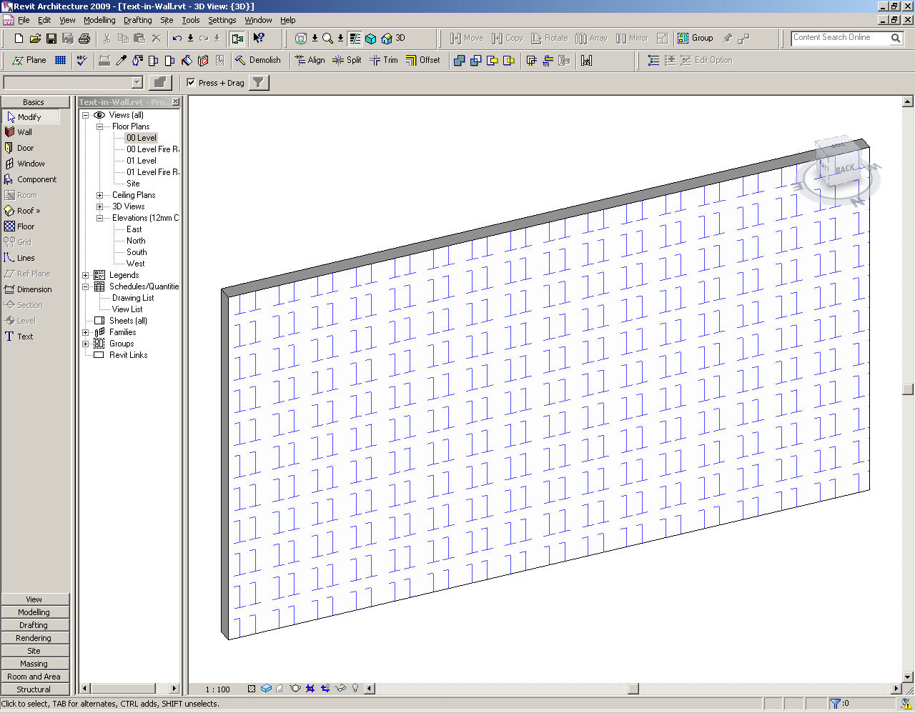

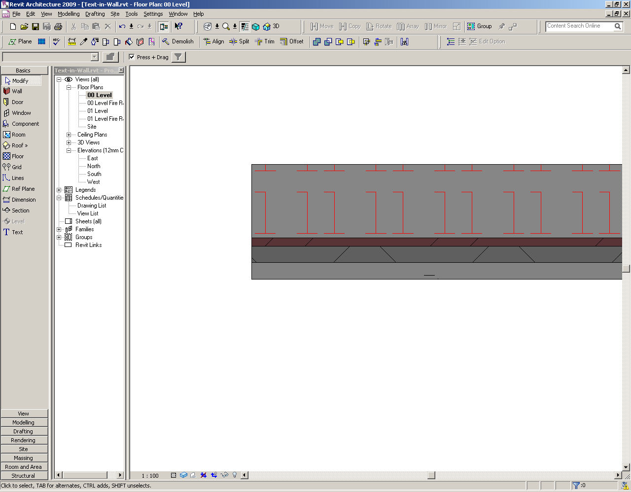

Wed, Dec 3, 2008 at 7:47:46 AM | Rated Fire and Smoke Walls
KingRevit
Joined: Mon, Oct 15, 2007
321 Posts
4 Stars: 12 Votes
For once mr spot isn't 100% accurate.
it is possible to do what you are after. it takes a bit of work but can be done. its a bit of a workaround.
see the file that i have uploaded.
i will make a vidoe tutorial on how to do this but you will see i have added "1" as  the text that i wanted to show. it shows in cut plan and also 3D surface pattern.
this was only a quick test that i did so the text isn't great and the spacing isn't great either but with a little bit of work you can achive what you are after.
