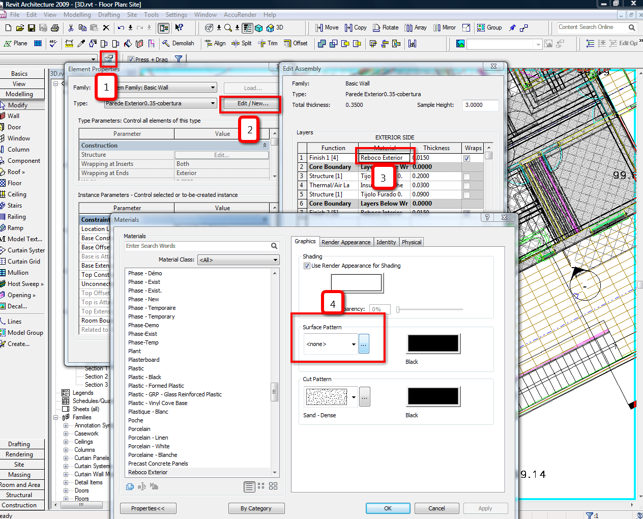

I'm lost trying to figure out how to get a checkerboard tile pattern on this wall, can anyone point me in the right direction?

Hi, what wall?????  in the properties of the wall you can put/change the pattern you want:

4 1/4 tile wall, I need to create a checkerboard pattern red/white so that it renders.

get a photo of what you need to render then chose a materail (one of the tile ones) and modify the material under - settings-materilas- render tab
