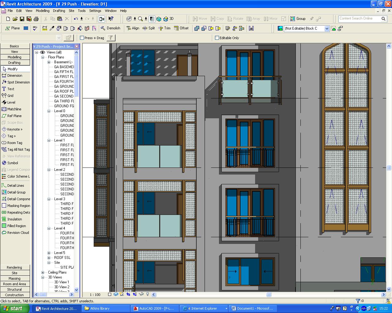

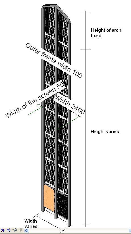

          Could any one help me? I need to create the screen family Cryingsee the attachment) this is coming in the exterior side of the walls, i was trying to create using generic family template, i created outer frames.  Then I started creating those sleeves by using solid and voids. is this is a correct way of doing? Because when i copy paste those sleeve panels system become very slow and i got some message saying use nested family! please help methank youpush

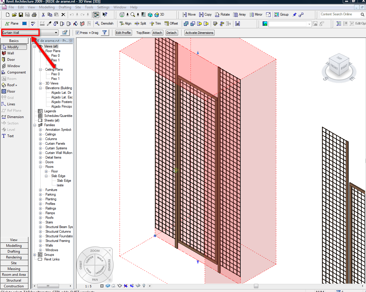

Yeah, when you use "Create-in-place" (solids and voids) you increase the size of your file, so the advise is create a "Family", in this particular case i use a "Curtain Wall" family...

Yeah, the "Curtain Wall" are very "Powerful", you can solve the problem with that, "if this is correct how to create the top prtion of this screen using curtain panels?" remember you can also edit the profile of the curtain walls to make the shape you want...

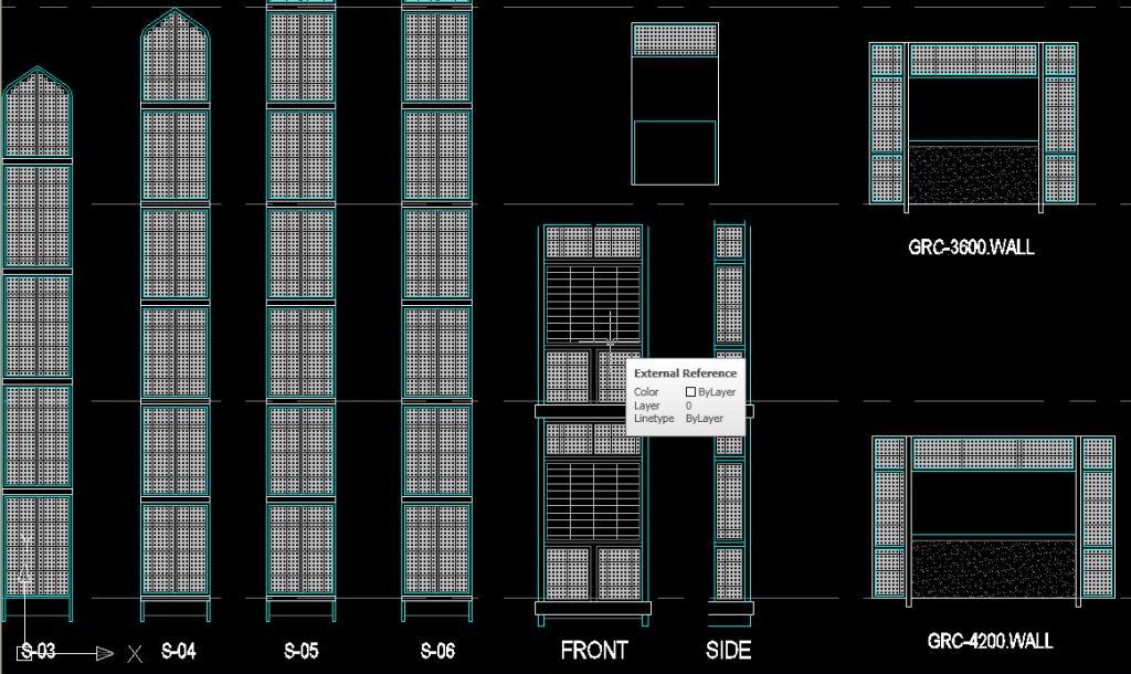

hi typhoon,                 Please find the attachment of different types of screens in my project. Could you please explain or refer me some tutorial to create these screens using curtain wall systems, i have no clue how to use curtain systems for these families. please help me.

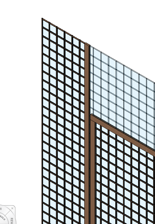

hi see the attached images, in revit for construction issue purpose i used glass and hatch pattern to get this screen effect in elevation but now i want to render it! how do i apply material to look like the real screen as seen in the attached image?typhoon i tried in curtain wall but did not manage to get it right.Thank youpush

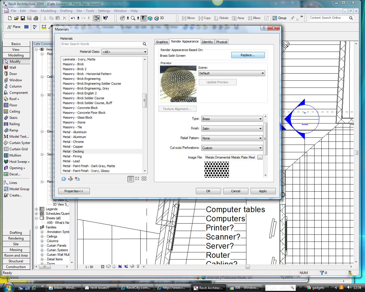

Create a material with a cutout map of light and dark areas.  You can create your own if suitable ones are not in the library.

I told you to use the "curtain Wall" family...
in this way you can choose to put (or not) the glass in the panels... but in this case you have all done so do like Tim123 said...

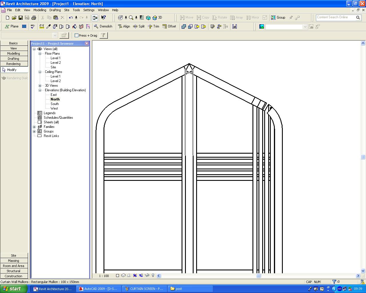

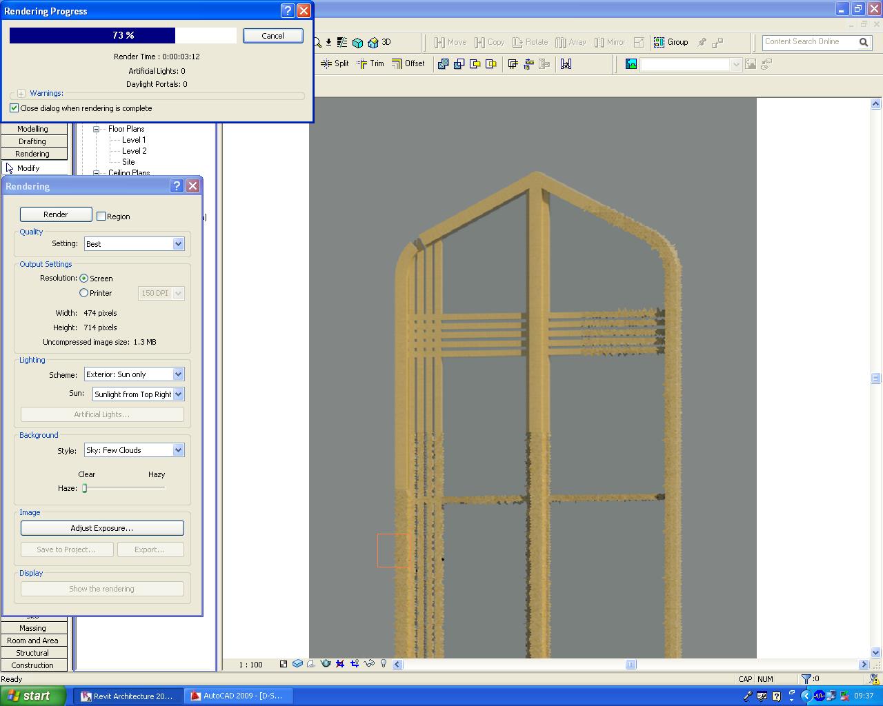

hi typhoon,                  Yes i tried with curtain walls, it works fine except the top portion (see the attachment) in elevation mullions breaking and i need angular grid at the top ( can we create angular grid?)...................... i think i have to follow what tim123s said.....but i don’t have Photoshop to create the mapping material..........i have to find the way out...........if some one already had one please provide me.thank you
