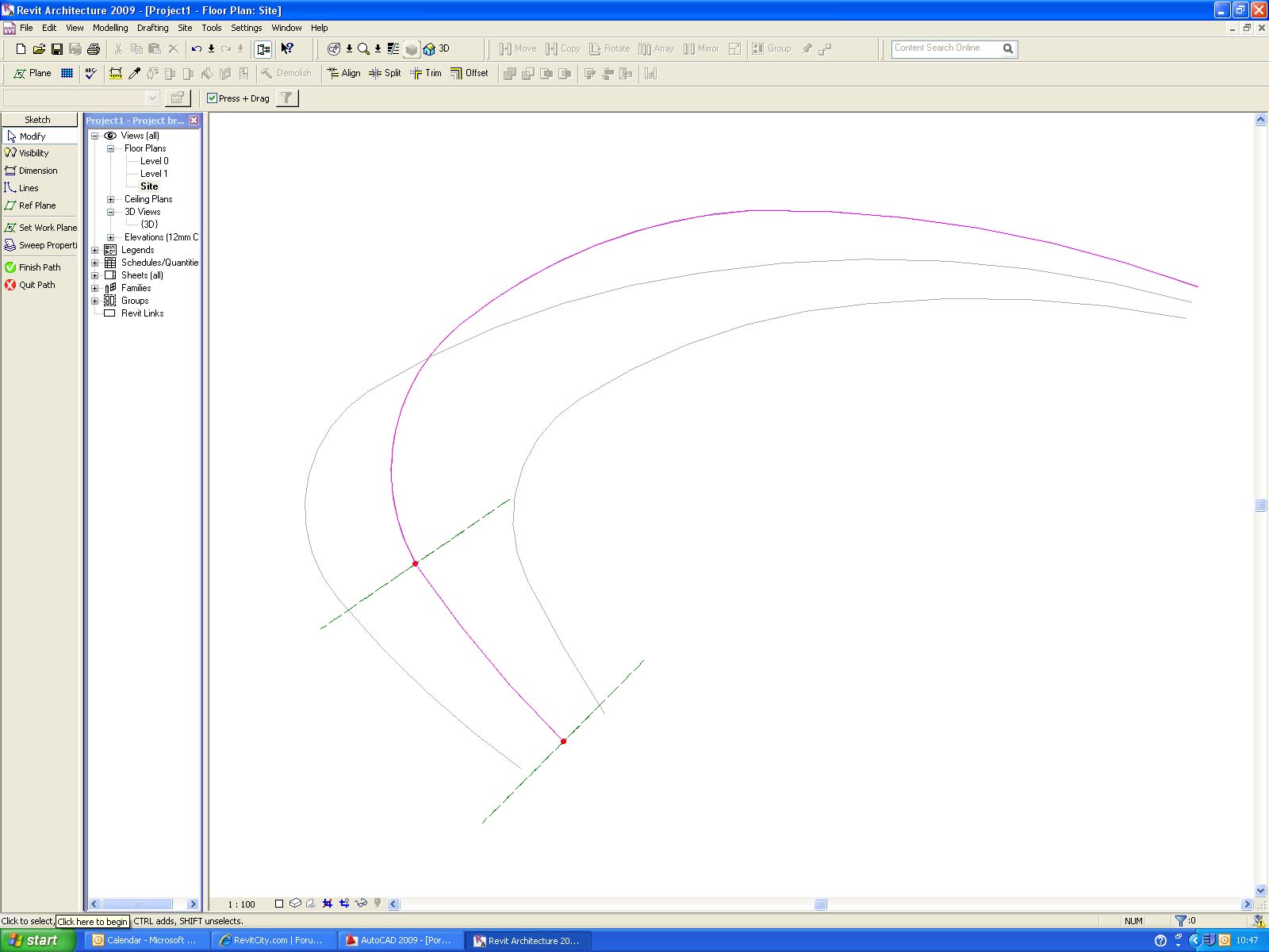

Hi i am trying to model a massing object using a swept blend, my sketch path is basically the NIKE swoosh a line consiting of 4 different arcs, i tried picking these 4 arc which i have line drawings for but get the error can not create more than one curve? What does this mean?
I also tried to over trace this path using a spline, it allowed me to create the path but then when i had done my 2 profiles at either end it would not copmplete the sweep blend.
Has anyone got any tips on how best to use the swept blend tool what i should avoid doing.
Please see attached image of my path, i will need to create 3 masses on the 3 paths in the end but i am having problems creating one at this stage.

Hi, see this: http://screencast.com/t/YVxPzaWUzH
