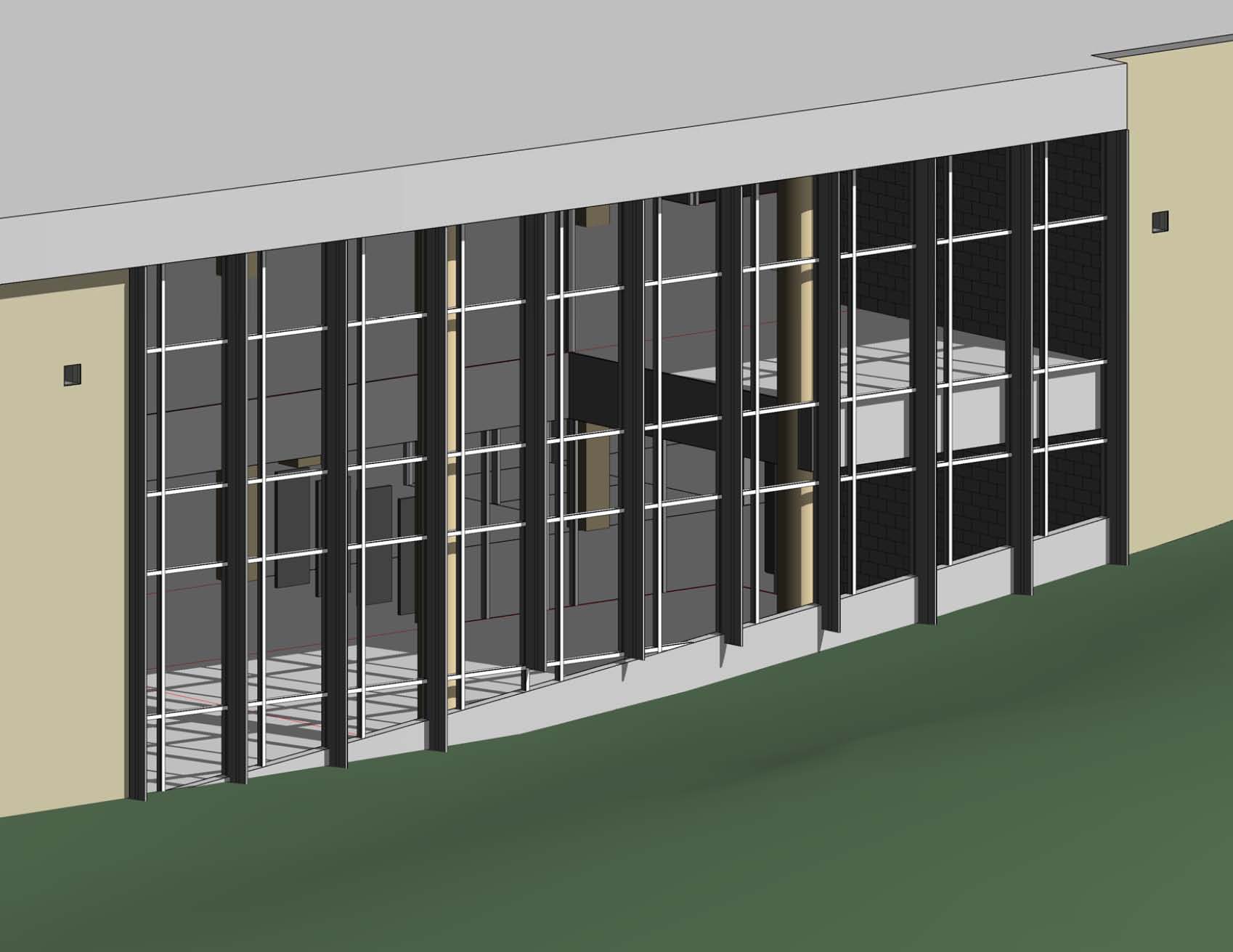

I am currently trying to create a radiused curtain wall that begins at the second floor and slopes down to the first floor... well I have it modeled in radiused and all looks good but I have to kind of fake it right now by creating a foundation wall that curves and slopes upward to hide the bottom of the curtain wall... if the wall were straight I could simply edit the profile so one end was higher than the other.... the way I have it now I cannot show the bottom mullion.  I think I could probably accomplish what I'm doing by breaking up the curve into segments between each mullion but that would leave me with over 30 separate curtin walls to manage.  I think this would be fine for CD's but I'm still in SD... ANy suggestions??

I found a previous thread in which a similar problem was encountered and it said to use a reference plane and attach the wall to it.  This worked great!! Thanks Coreed!

edit the profile of your curtain wall
