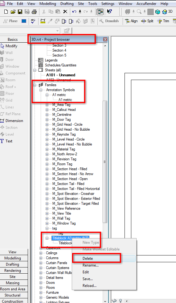

Does anyone know if it's possible to delete or purge out title blocks?
I was modifying title block and created multiple versions to compare.
Now I am trying to delete the ones I do not need and I can't seem to find title blocks from 'purge unused'.
Any suggestions please?

Hi, i think this is what do you want, in Project Browser-Families-Annotations Symbols or tiltleblocks... see the image

ah, just what I wanted to know.
Thanks, so much.
