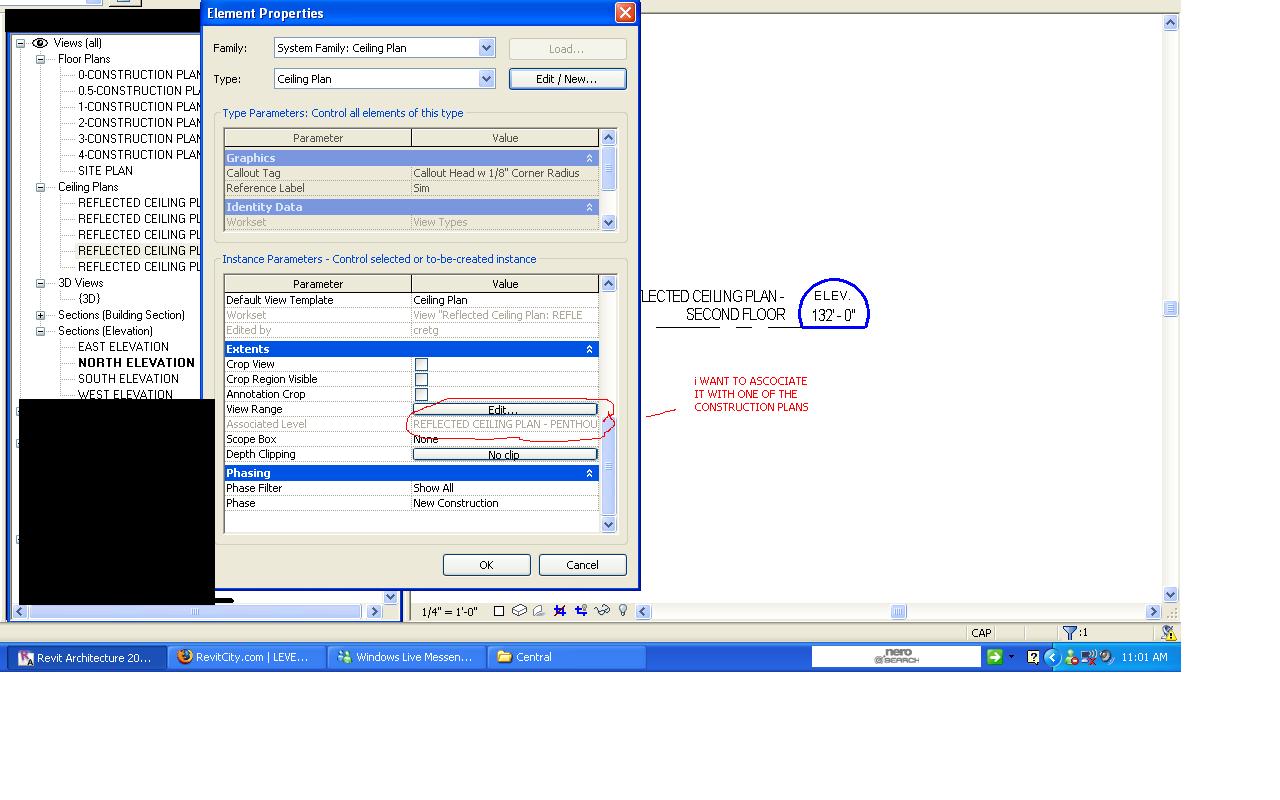

WHEN I CREATE A NEW LEVEL FOR A CONSTUCTION LEVEL IT ASSIGNS IT TO A REFLECTED CEILING PLAN LEVEL HOW CAN i CHANGE THIS. ITS LIKE THE LEVEL IS LINKED TO THE CEILING AND NOT TO A FLOOR

how are you creating your level? are u using the level tool or copying an existing one? have you your plan view types set to both ceiling and plan (this is on your options bar).

if you don't want any plan made un-check Make Plan View in the Options Bar. If you don't want a ceiling plan made click Plan View Types in the Options Bar and take out the ceiling plan.

SO i CHECKED AND THE LEVELS WERE MADE NOT COPIED. TE PROBLEM IS THE ASOCIATED LEVEL IS THE REFLECTED CEILING PLAN AND i NEED TO CHANGE IT TO A CONSTRUCTION PLAN

its to do with your worksets have a look at them

PRBLEM SOLVED THANK YOU EVERYONE

It wasnt so much as a fix but a walk around. I ended up selecting everything on my level copying it to clipboard. then deleting it all. then I went to an elevation created(not copy) a new level. the go into the new level and pasted it aligned. A dumb walkaround but saved time in the end.
hope it helps if you still have trouble post up your file and I can take a look at it
