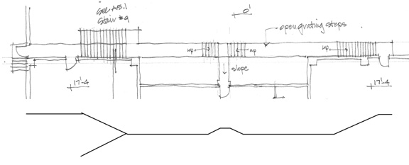

I'm modeling an existing stair/catwalk element and think it would be peachy to model it as one element.
Does anyone know if it's possible?  My suspicions lean toward 'no' but thought I'd check with the community.
See attached image.
Thanks!

only way to do it as one object is to create an inplace family. as far as i know
