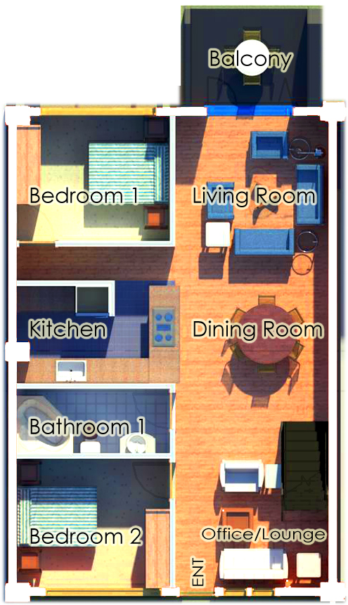

how I do a render of a plan - for example a ground floor or a roof plan?
 orthogonal
 thanks a lot

you mean like this?

yes , exactly, i tried witd 3d viws , but dont make so perfect.
I apreciate you tell me how you can do this !( looks really nice)

No problem..
first of all.. you need to duplicate your 3dview/ {3d}
Then with the new "copy of {3d}" open go to View options menu at the top of the screen, so its
So..
view>
orient>
to other view>
then select your floor plan or roof plan ,
then you'll be be able to access your render option as well.
let me know if you need anymore help
Ross

Hi rossaftermath,
Thanks for the post, but is it possible to render a view that is NOT in perspective, like the one you showed?  I can orient the camera to different views - elevation, section, plan, etc. - but they are all perspective.  Please help!
 Thanks.
Thu, Dec 1, 2011 at 10:36:38 AM | how I do a render of a plan - orthogonal ????
Click on the house (3D) icon.  Now click on the top of the box and render this view.  If you need a plan, use a scope box.
Thu, Dec 1, 2011 at 10:50:45 AM | how I do a render of a plan - orthogonal ????
AlphaOjo
Joined: Thu, Sep 15, 2011
21 Posts
Great.  Thanks!  I guess what wasn't clear to me was the different between camera views and the ONE default 3D view.  I didn't realize they were different, even after a year of using Revit!
