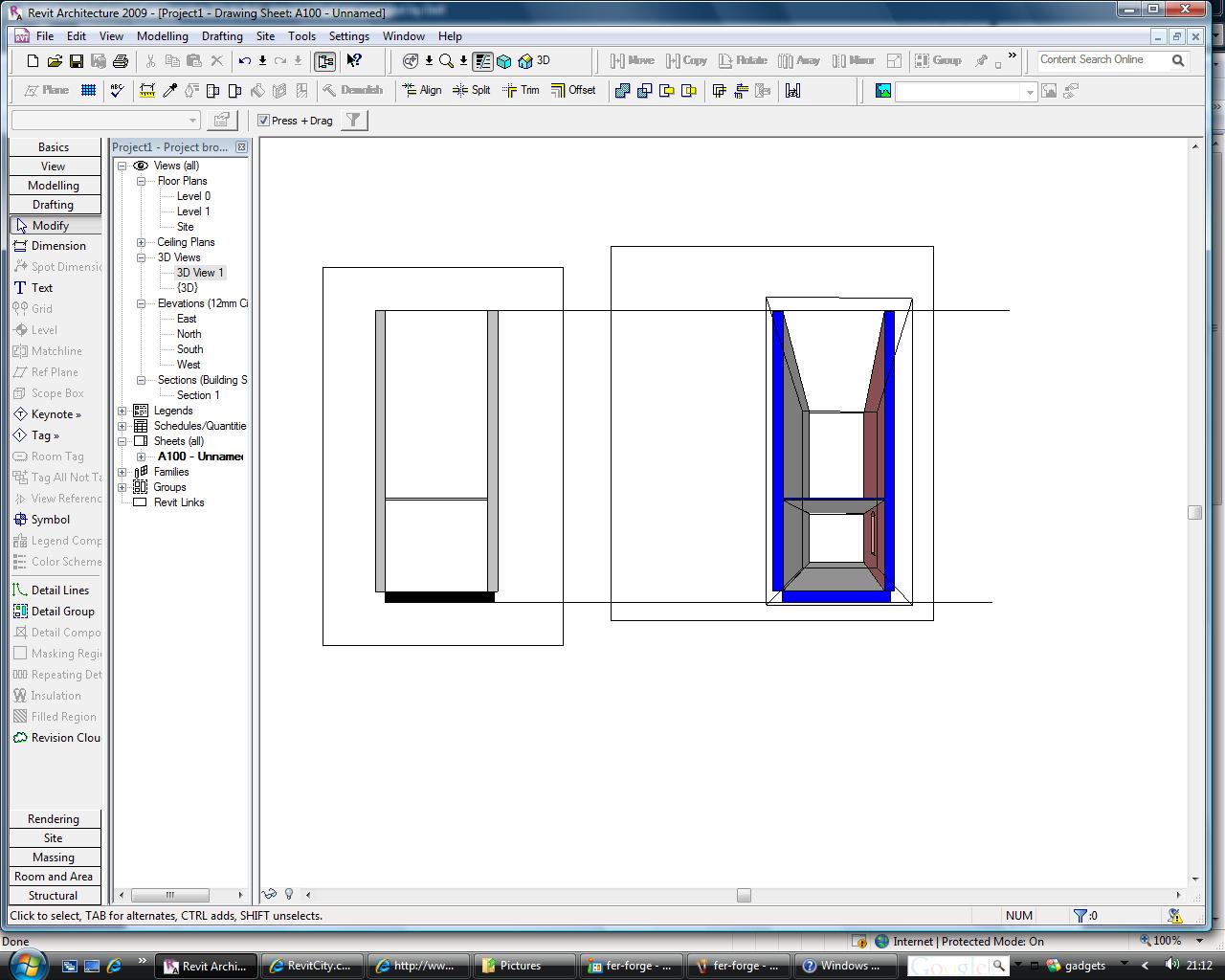

I'm trying to create a sectional perspective to a particular scale--I've read most of the posts on sectional perspectives. Any suggestions?

There is never a scale to a perspective since all items diminish with depth away from the viewpoint.

I realize that a perspective can't be scaled. I would like the section part of it to be to a particular scale, i.e. to be able to set the scale at the cut line.

I too am interested in creating a section perspective in which the section cut is set to a scale, and the rest of the building is in perspective. Any suggestions would be very much appreciated

As WWHub sugests, a section can not be to scale.  If your camera view is perpendicular with the view you could eyball it, as you could adjust the size of the image.  Of course this will never be totally accurate as the width and height would vary depending on the camera position.

The only way i know is by using photoshop.  Export a regular section cut, then export a sectional perspective.  Then use photoshop to scale the sectional perspective.
