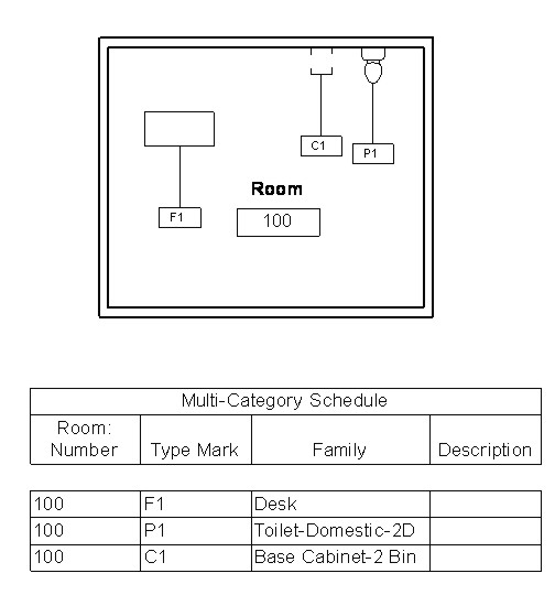

Something you may want to take a look at is a "multi-category" schedule. In the attached JPG I have items from three different categories scheduled. The other thing you might want to consider is whether or not the items you are placing in each room really need to belong to different categories. Maybe you change all the family categories to the same type. Depends though on what your final needs are. HTH Tom

To get the schedule to appear only for a particular space, you are going to have to apply a filter to the schedule. If all of your spaces are rooms, you can filter by room number. If a space is comprised of more than one room, then you will have to add a shared paremeter called space number or something and share that parameter with the room tag, then fill in the space number into each collection of rooms that you need to and filter by it. Unfortunately, if you have 50 spaces, you are going to need 50 schedules each with a different filter. I would get the first schedule to be exactly formated like you want it then duplicate it and just change the filter in the duplicate (49 times for 50 rooms). I don't know of any way to automate this process in Revit. HTH Tom
