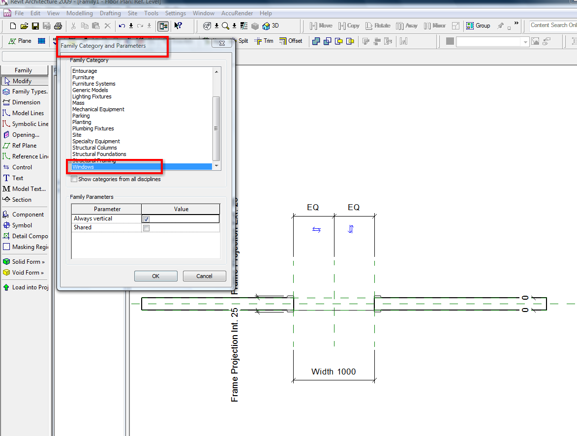

I started a family type out as a door (for an existing masonry opening in an existing building) that was later in the project decided to be a window. Now when I try to tag it it perameters are set up for a door (now a window) and doesn't tag properly. Do I have to redraw the item (very detailed) or can I change the family in some way?

Found a pervious post that answered this question. Thanks!

Hi, edit the family, go to "Settings-Family category and parameters" and change to "windows" category, this solve your problem, i think...
