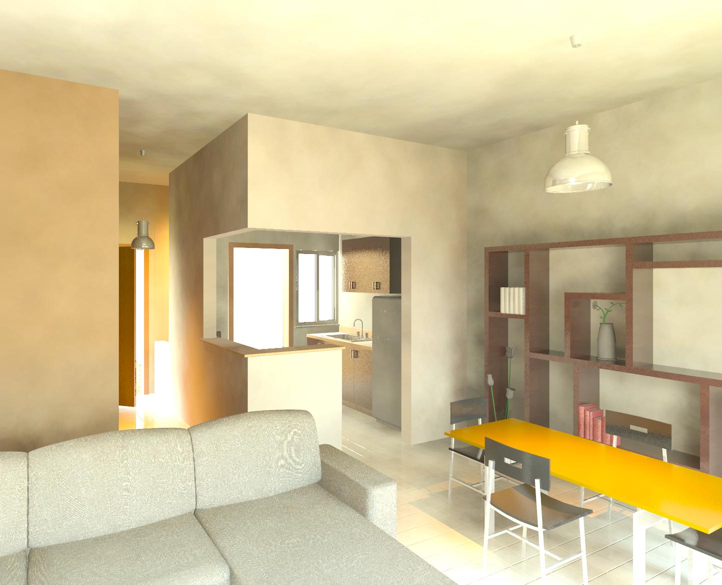

Tue, Apr 30, 2013 at 2:25:01 PM | Interior Rendering is very Dark
AHMR
Joined: Tue, Aug 19, 2008
1 Posts
Every time i render interior scenes, the walls look like dirty, and bumpy. (as Shown in the pic)
What can i do to get clean smooth surfaces?
Thanks everyone
Tue, Apr 30, 2013 at 2:30:55 PM | Interior Rendering is very Dark
These are a direct result of the materials you have assigned.  You are in control of those and part of learning revit is experimenting with the material controls to see what they do.
