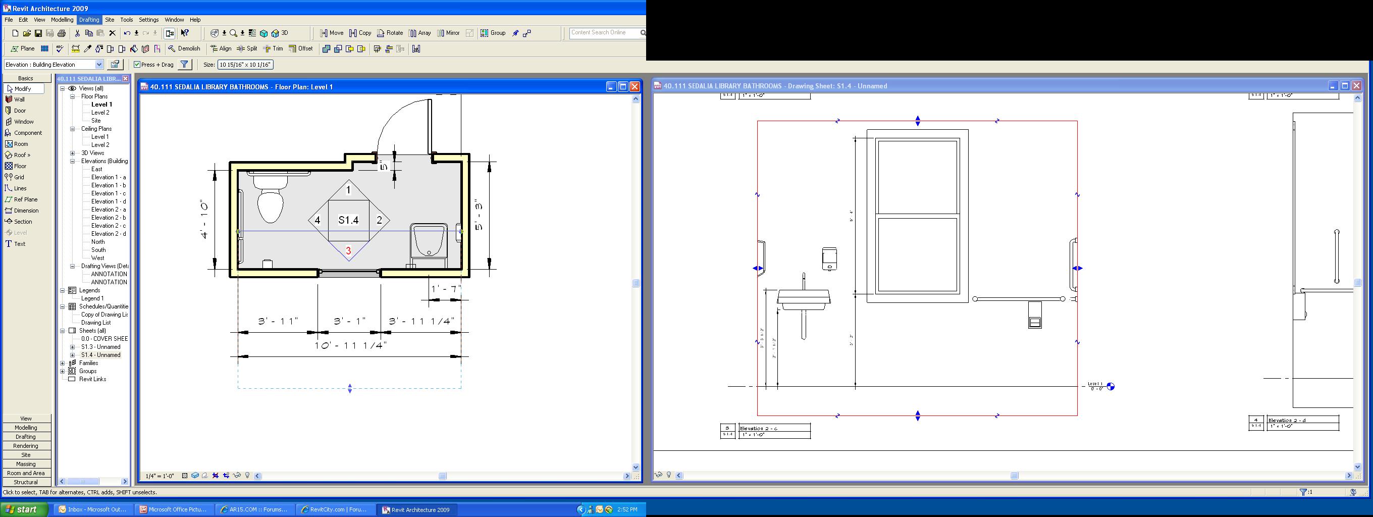

Please look at the attached image.  On interior elevation 3 you can see that you see all three handicapped bars show up in the section.  On the floor plan you can see by where the line is that you should only see the side bar and the vertical bar.  I have also had issues like this in shower stalls.  Can anyone tell me how to fix this so you see only what you are supposed to?
Thank you,
AAron

Well .... you are learning a REVIT lesson.
I bet you either have all of these in one family or they have invisible "insertion point" lines.  For non-cuttable families, if any portion of a family is cut or shown, the whole family is shown.

They are a family.  So no hope, huh?
Fri, Nov 14, 2008 at 4:13:15 PM | Visibility/transparency issues. Not seeing through items in interior elevations
Rebuild the family & split it apart.
All of the ones on one wall could be a single family .

Hi, did you edit that family and check the visibility in the detail level (coarse, medium and fine) mode???
