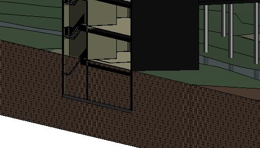

I've created a couple different pads in the project that I'm working on. All of them work except for one. It's not cutting the topo. I've checked the properties for the pads that work and I'm basing the pad on the same level as the other pads and then offsetting it, but it still wont work. Any ideas?

Here's a picture. The floor slab 15' below the surface is the pad.

I fixed this problem. I had made several sub regions to the topo surface and apparantly it wasn't cutting through one of them. I deleted the subregions and redrew them and it fixed the problem. Weird.
