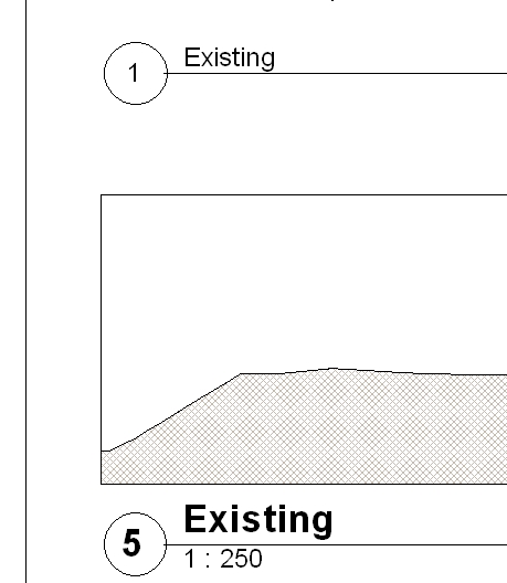

I can successfully change the size of the View Title text via duplication of the existing, but i cant seem to find where to change the size of the circle! Can you help?

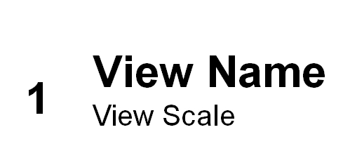

I have tried that but i cant find the circle to modify, what i see is attached
cheers
Thu, Nov 13, 2008 at 8:40:37 AM | View Title Circle size
Thread Post Kudo! #4
Turn them on under annotations in VG in the family editor.
