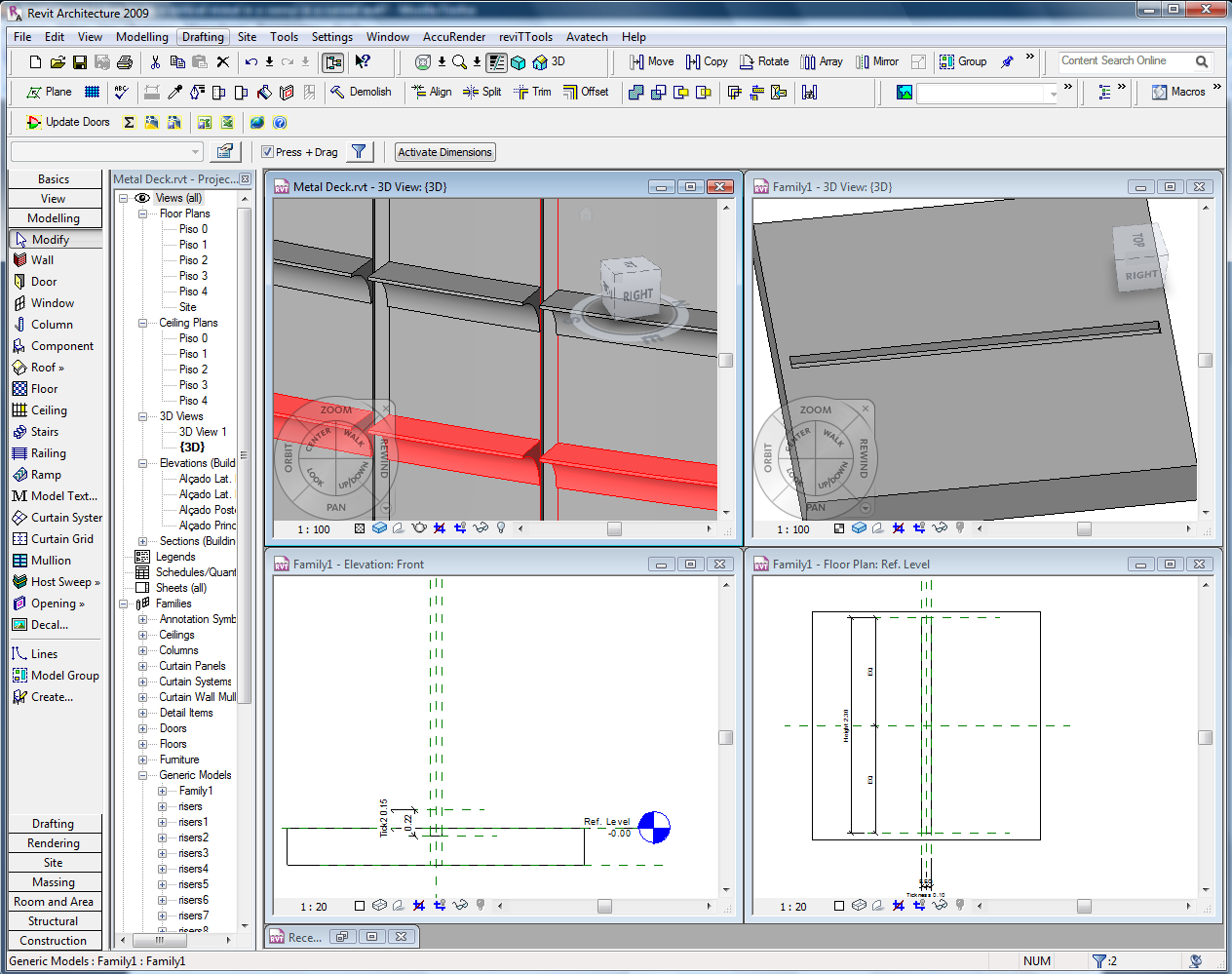

Hi, can you put some screenshot to figure what really are you trying to do?? But to cut the wall sweeps i think i create a "Generic model face based" with a void...

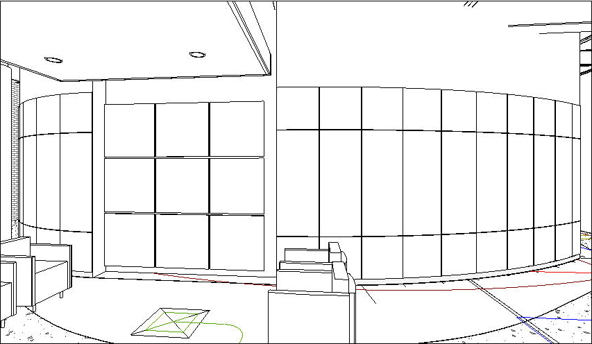

Yes, here is a screen shot. I managed to put some vertical reveals in there using solid, instead of void, extrusions in the wall sweeps, and and assigning black for the material.
Since the solids are just attached to the work plane, and aren't dependant on "cutting out" a geometry, it worked. It renders OK, but sort of avoids the problem. Still not sure if doing voids is possible.

I was able to do it by creating the reveal as a trapazoid with the smallest side in the wall and the largest side about an 1" 'outside' of the wall.  That was for a convex curve.  I imaging you would have to make the smallest side of the trapazoid on the outside for a concave wall (but I haven't tried that yet).
