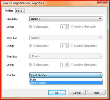

I've also gone in and set up parameters to sort the drawing list in the order we want (2 actually - one for the discipline and one for the sheets). I've used these to sort the browser and we get the sub-folders which we just deal with. When I go to set up a new browser the only thing I see under sort is Sheet Number and Scale (see attached).
I've added bot a shared paramter and

Unfortunately, as far as I know, you can't dictate the order in which sheets are sorted within groups; just the order that groups are sorted.
