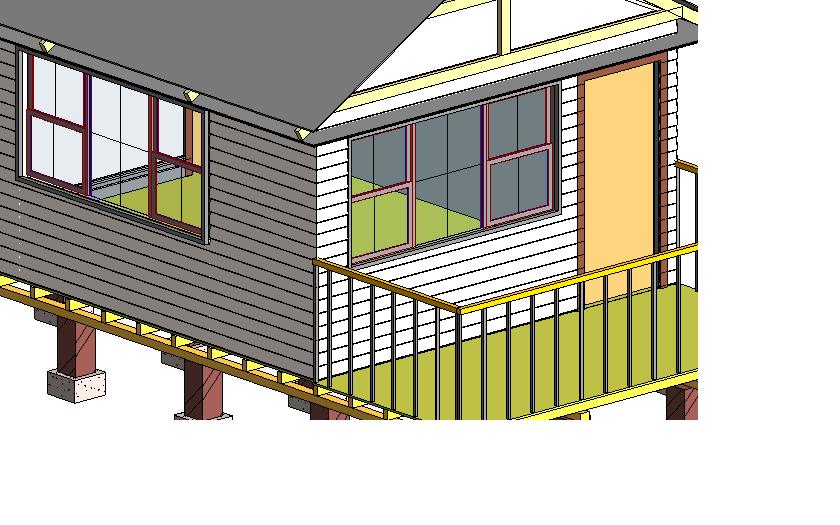

I'm using the window sweep to create a weatherboard profile around my walls. however, the sweep will cut thru doors but not my windows. I saw another post showing it could be done. In the constraints I've checked "cut of inserts" but that doesn't seem to work.
Any trick to this?

Can you post some images to check?

I got around the problem by, splitting & Joining, whilst adding multiple sweeps to the wall. Its not ideal but I guess it works. I had see in another post, where someone was able to have the Host sweep cut thru the windows not just the doors. Is this possible or not?
