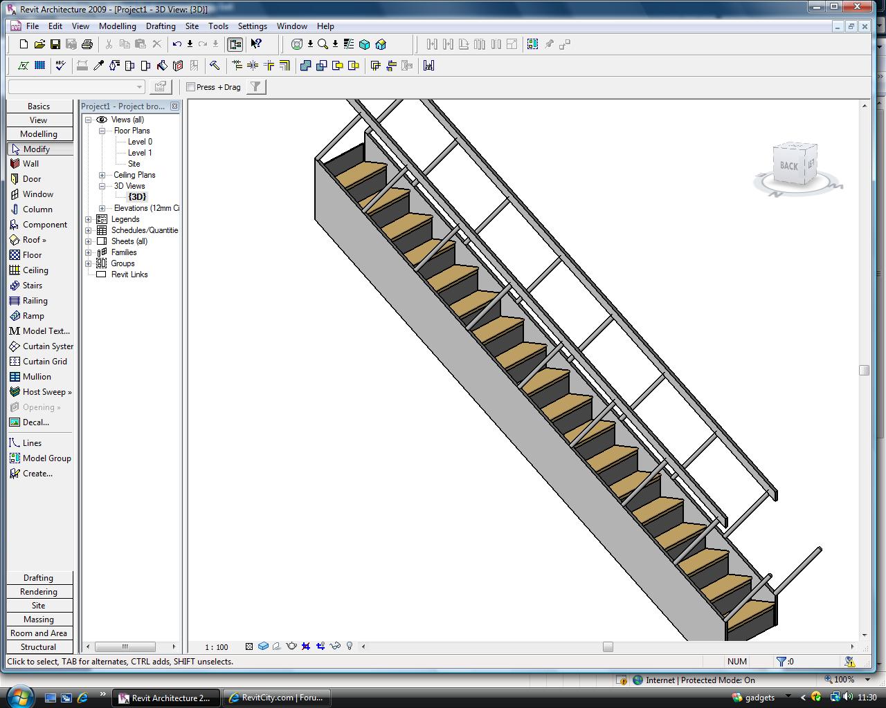

How do I angle my custom made balusters to be perpindicular to my stringer?
I am using REVIT Architecture 2009
Thanks in advance!

You can create a baluster family attached to a reference line with an angle parameter, or locked to the angle of the stringer

See attached image.
