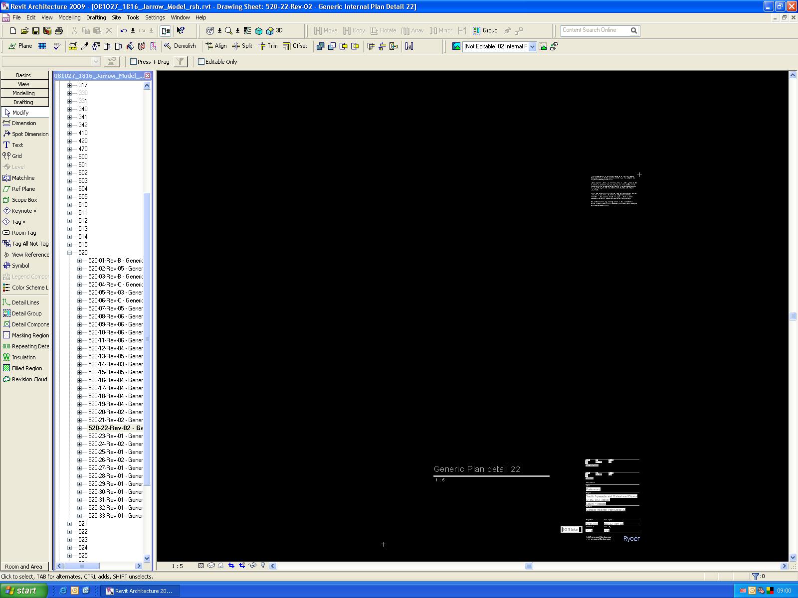

HI,
Anybody facing this problem.
After few minutes my revit screen changes(see attached snapshot)
It seems to be a graphic card problem but not sure ..
Thanks in advance

is probably has to do with your OpenGL Hardware. try turning it off and see what happens

Thnx coreed
I have tried that option many times but no improvement.
Is revit reinstallation is a solution?

it's one that has solved many of my problems in the past. also make sure you have all the latest drivers for your grahics card installed.

Instlling the latest version of graphic card solves the problem.
