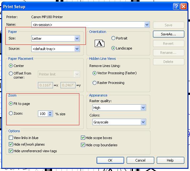

See the attached image. To get to print setup goto FilePuhrint Setup. You can also goto it from the PrintPuhrint Setup dialog.

Maybe I wasn't clear. Set up the sheet however you want it to look. Full size. Title Block, text, Dimensions, what ever. Then print it to "Fit" on what ever paper you want. It is really exactly the same thing as printing to "Fit" or "window" in any program. I do mini check sets on 11x17 all the time.
