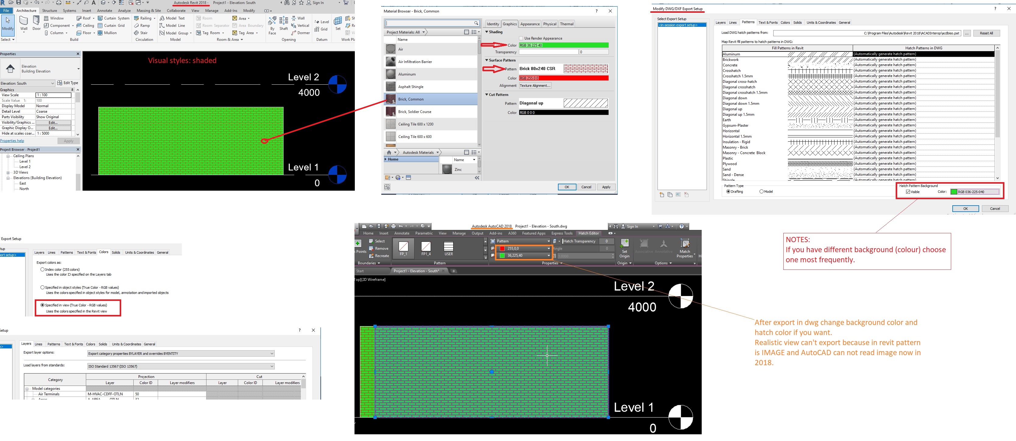

Sat, Mar 31, 2018 at 3:07:56 AM | EXPORTING TO AUTOCAD- WITH NO COLOR FILLS
#10
Va3ilem
Joined: Sat, Dec 31, 2016
0 Posts
I have the same problem: color fills for my elevations but i solved some way. See picture.
