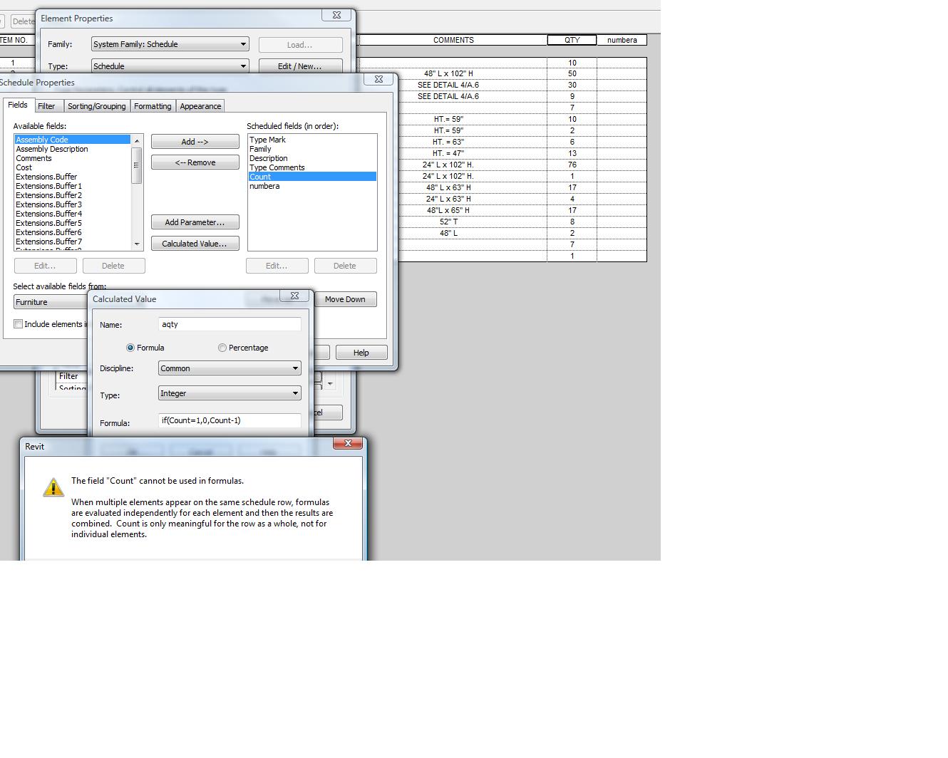

i am working on a clothing store, and i have 20 different cabinet fixtures, no1 to no20
in autocad, produce a furniture schedule, ((assuming  i am not using the smart scheduling)))))
this schedule will be like
Column one = fixture number
column two = fixture description
column three = fixture count
all the items  in the schedule are not "live", have to input and modify manually
**************************************8
if i want to provide the same schedule in revit
the furniture itself is parametric, contains all the tags
the columns of the schedule will look similar
column one two and three will be smart....great
Question
Let’s say for a particular project, I am only using fixture 4-20, 1-3 will not be use
The results of this schedule will only show fixture 4-20
What if I want the schedule show all fixtures, but fixture 1-3 have not been physically placed onto the revit fixture plan
one way is to place a row of the entire fixtures 1-20 onto somewhere above the plan, and alter the scope box so it wont print
Under the schedule parameter, have a new column, set a “calculate value” of [count -1 ], that should do it
BUT
Revit won’t allow the use the column “count” as a formula
THE OTHER OPTION
Use if statement
If (x=null, 0, x ) …but I don’t think revit have “null” value
or else do some extra crazy column…….to take column x -1 , and show it in column y……..ahhhhhhh
Any suggestion???

mcdg, you need to edit the family of each furniture item and give it a shared parameter with a name such as 'furniture count' or something, you can change the schedule heading to count if you wish.  This must be an instance parameter set as an integer with an initial value of 0.  Load it back into your project and give it a value of 1 when you place it.  You can include this as a parameter in the schedule and total it.

that works
one more challenge
is there any other way, just using if statement, without tagging or adding new parameter to the furniture family
i am asking this is becasue the furniture family were given to us by our clinet, and they are stubborn, they will not add any new parameter to any of their furniture family......i am just afraid ppl will forget ( in our office )  to add the parameter  each and every time we receive new update family from our client

Please see the screen save for a better description of my action
