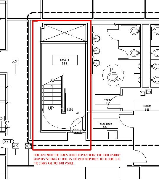

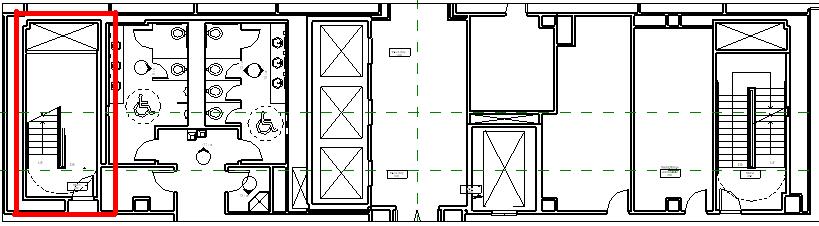

For some reason my left stairs will not show up in plan, although the are present in section view.  I've tried playing around with the visibility settings in both the Visibility Graphics as well as View Properties, yet it still doesn't show up.  How do I fix this problem?  The right set is showing up fine.  So I don't know what I could have done wrong.  Anyone know of a solution? I've attached some images to make it easier to understand what I'm talking about.
Thanks!

I figured this one out.  All I had to do was create a new shaft all the way up to the tenth floor for on the side I was having issues seeing.
