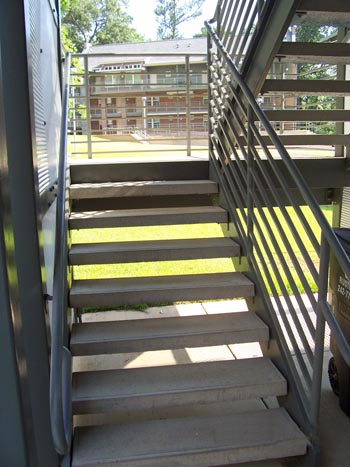

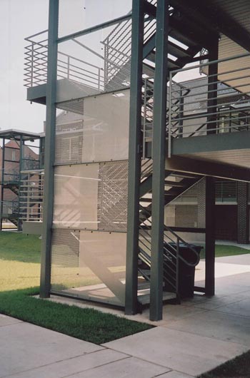

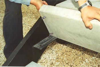

 I started using Revit about 4 months ago for a large project.  I want to make a set of custom stairs, with concrete  precase treads.  See attached images. They height of the stairs vary from floor to floor.  This is a ten story building with what should be two different floor heights.  I'm pretty sure that I will have to create a new system family for them.  How do I start?  Does anyone have any links to a "How To" instructions?  Or any suggestions?

You can create your own stairs within the guidlines of the stair properties dialogue box.  It's a bit tedious and somewhat limited.  That being said, the stair you posted a photo of should be fairly simple to recreate.  Read through the help then start experimenting.
