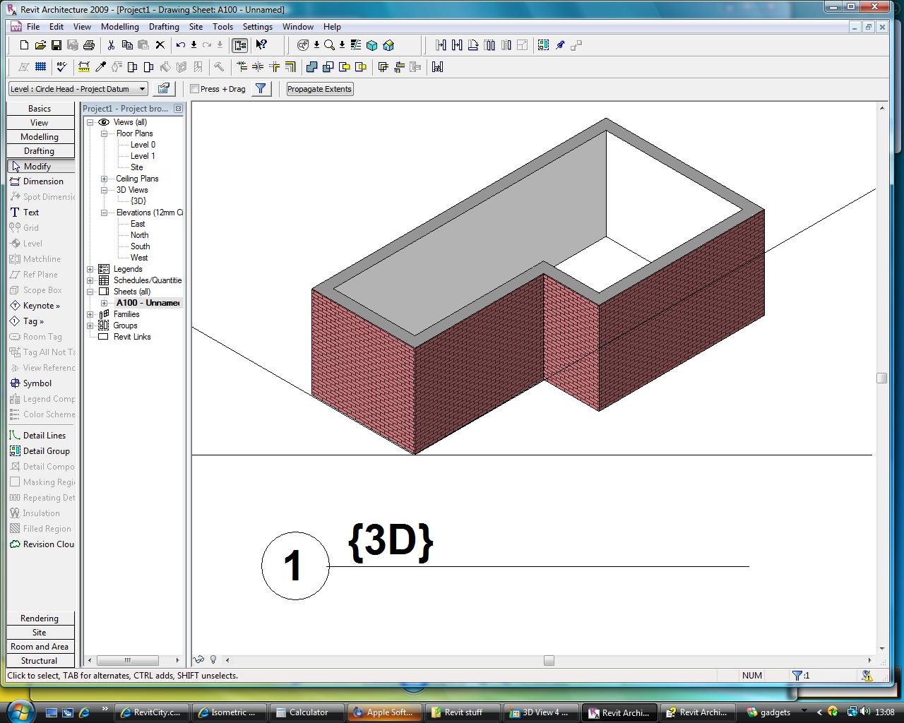

You can create an approximation of an isometric view by drawing 30 degree lines on your sheet and rotating your default 3d view to fit - see attached image.

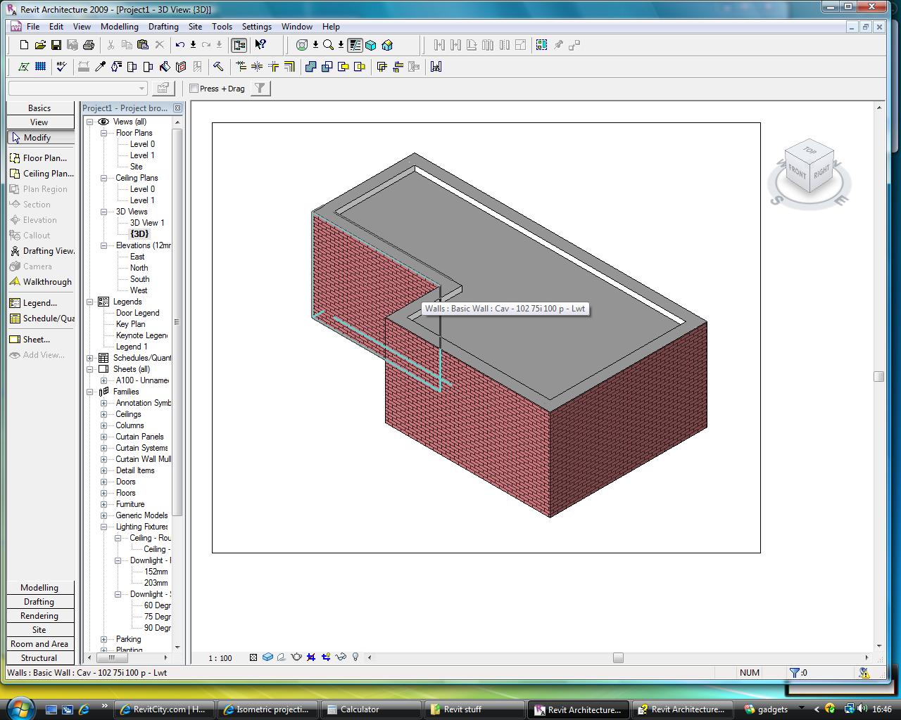

I used a default 3D view and used 'Orient' under view to align it to the east elevation.  In the south elevation I rotated the camera by 35.264° (although you can also type in the formula above instead of the number) around the default base point.  I then rotated the camera by 45° in the plan view by moving the base point to the camera position (it snaps here).  The result is shown in the attached image.
