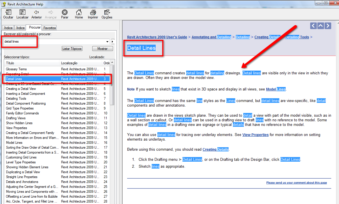

hey ,
i am also trying to make a window and have some doubts although the doubts are more general.
1. why am i not able to draw detail lines in family editor
2. when i want to show symbolic lines ( instead of detail lines) in exterior elevation , why do i see them also in interior elevaiton ie why are sybolic lines seen in opposite view.
say for eg . i want to show some joinery only by symbolic lines in exterior elevation(like shutter swing) but not interior , and i make them with symbolic lines, i still see them in interior elevation . why?

Hi "3drulez" you must try to Start using th HELP menu from revit, it's very helpfull and easy to use, try also to go here and see the tutorials: http://usa.autodesk.com/adsk/servlet/item?siteID=123112&id=11091739

although i have not read the help file. i have read the mastering revit architecture by sybex publication book completely and thoroughly. i have been lucky enough to get 13 gb of tutorials by daryl gregoire. and i have gone through them . but this one point i think is not mentioned there too.
this thing of not being able to make detail lines in a family editor is a big handicap. i then used model lines to show door swings in elevation as a workaround.
thanks.
