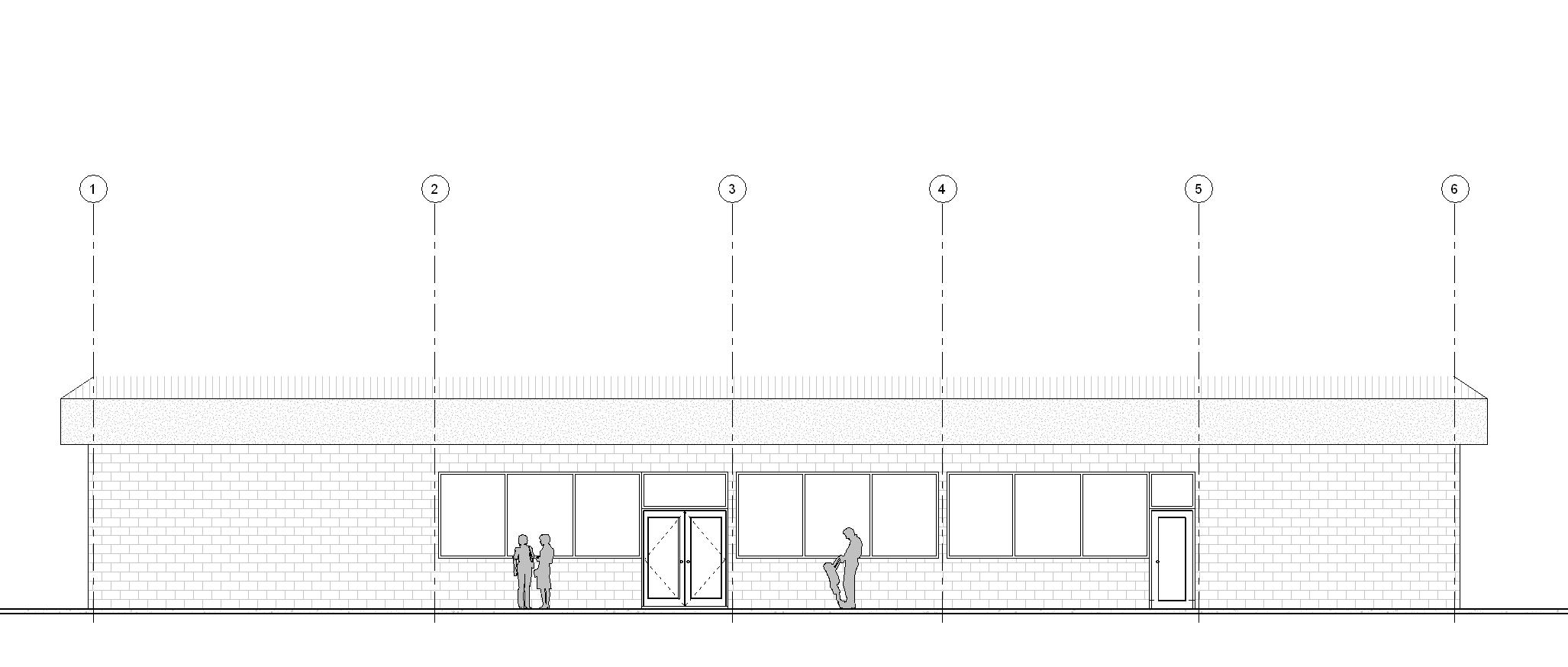

I've added a mass to resemble a mansard roof and in 3D view the entire mass shows.  When looking at elevation views only a portion of the mass shows.  Any ideas?  Thanks!

When exporting out my 3D image or an elevation into a jpg file it won't show the mass which defeats the purpose - any ideas?

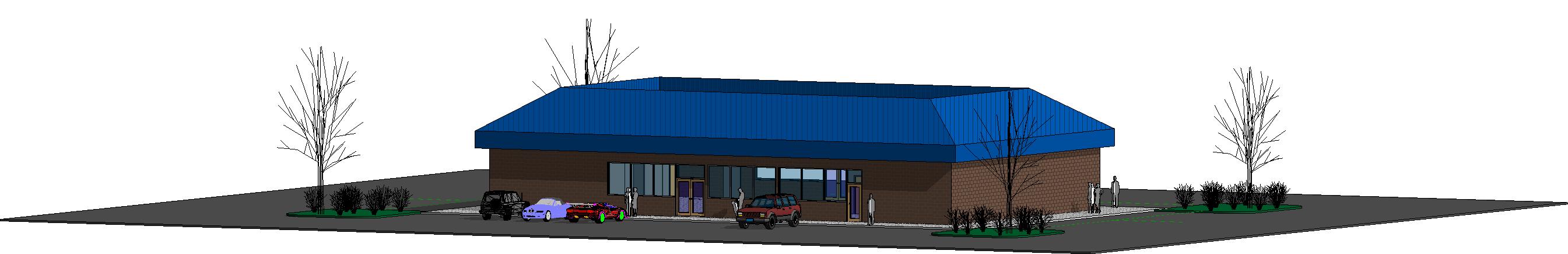

Typhoon - thanks!  Here are the images of the 3D view as well as one elevation.  Again, thanks very much for your help!

YIKES!  After I viewed the attached images the elevation view shows the entire mass but on my screen is does not...

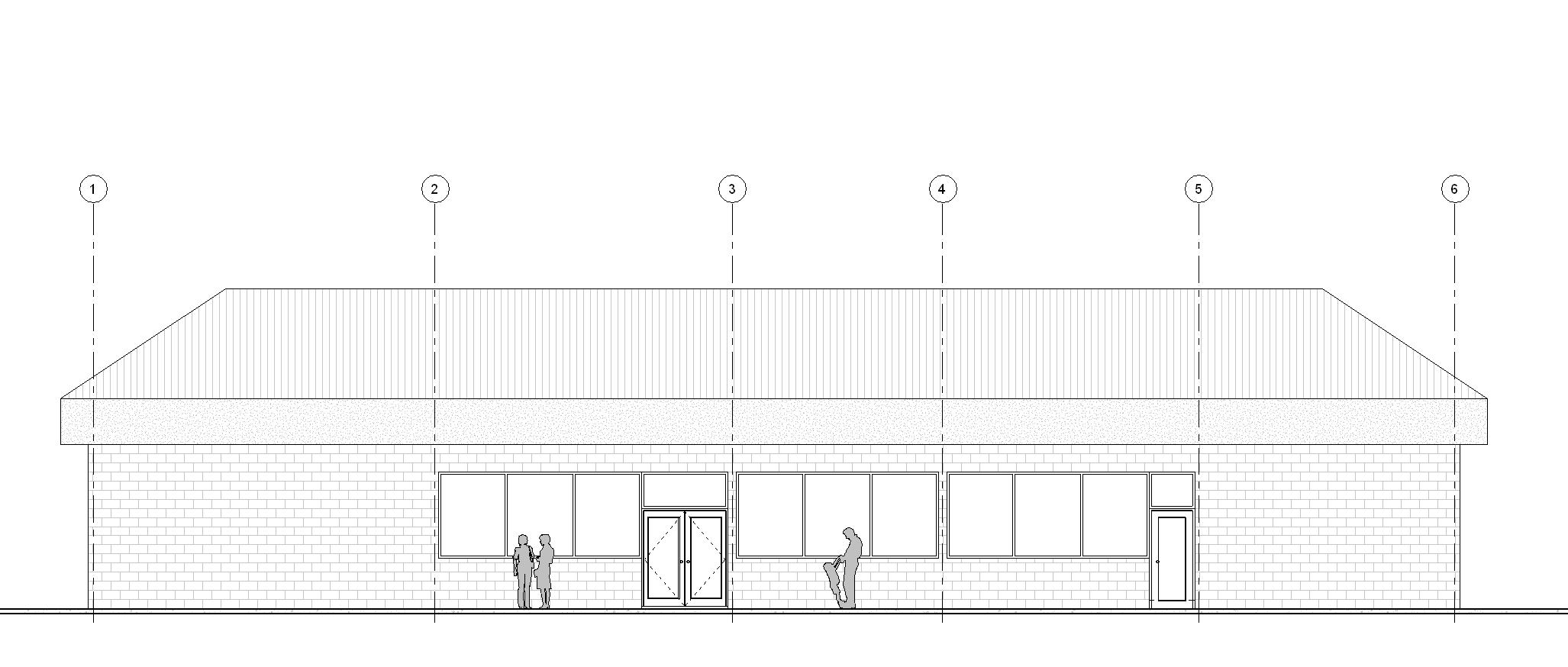

OK, sorry... try this image.  I had added lines and a filled region to resemble the mass and then hid them in view.

That "blue" roof is a "Mass"? go to Massing menu and pick in "Roof by face", select the faces of the roof you want, then in properties of that "New" roof you can change the tickness, material, components and so one, ONLY use the "MASS" to create forms easly and fast, then apply "walls, floors, roofs, curtain system", every time you open your project you have to check VV (mass) and so one.... Sorry (i must tell this soon) but i think the problem it's other....

try this thread...this may be your issue
http://www.revitcity.com/forums.php?action=viewthread&thread_id=8482
