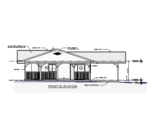

I need some help getting my four sided gable to work. I followed the tutorial within the program. It looks fine in the roof profile and 3D views. However, when one is viewing the front and side elevation where the two gables intersect the fascia line appears above the top plate level. I've tried numerous things to fix this but to no avail. Any help would be greatly appreciated.

I presumed the problematic part is the leftt side of your roof? I s your roof a one roof object or a couple of roof joined together? If its one roof object looks like to me an ovehang issue u might have diffrent ovehang lenght in your roof or you might have probably messed the plate offset properties.
