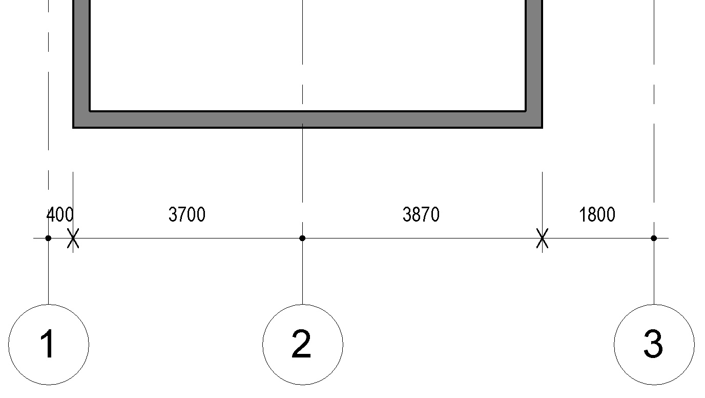

Does anyone have any advise on how I could incorpriate different Arrows, Ticks or Dots in the same dimension run. Also has anyone found a way to have dimension arrows greater than 90 degrees.
John A
Thu, Oct 23, 2008 at 7:31:45 AM | Dimension Arrows/Ticks/Dots
You cant do it in the same run.  You need seperate dimension styles.
