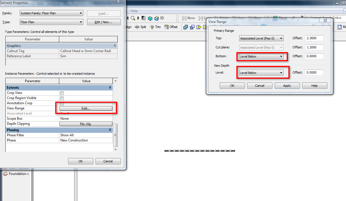

I am working on a framing plan, when I place a beam system will show up, but if I use a Beam won't show up on the plan, How should I make the beam to show on plan? I tried line work, it doesn't work, I checked level and it is the same as the beam system, I don't understand why beam system shows but an individual beam doesn't . Any ideas???
Thank you
Tue, Oct 21, 2008 at 4:36:54 PM | Beam & Beam systems
Joined: Tue, May 22, 2007
5921 Posts
4 Stars: 205 Votes
try in the view plan you want to see the Beam, go to VP and in "view range" change the parameters like you can see in the images attached, also in VG, go to "Structural Framing" in the "Projectio/surface lines - Override" you can change the color, weight and pattern...
