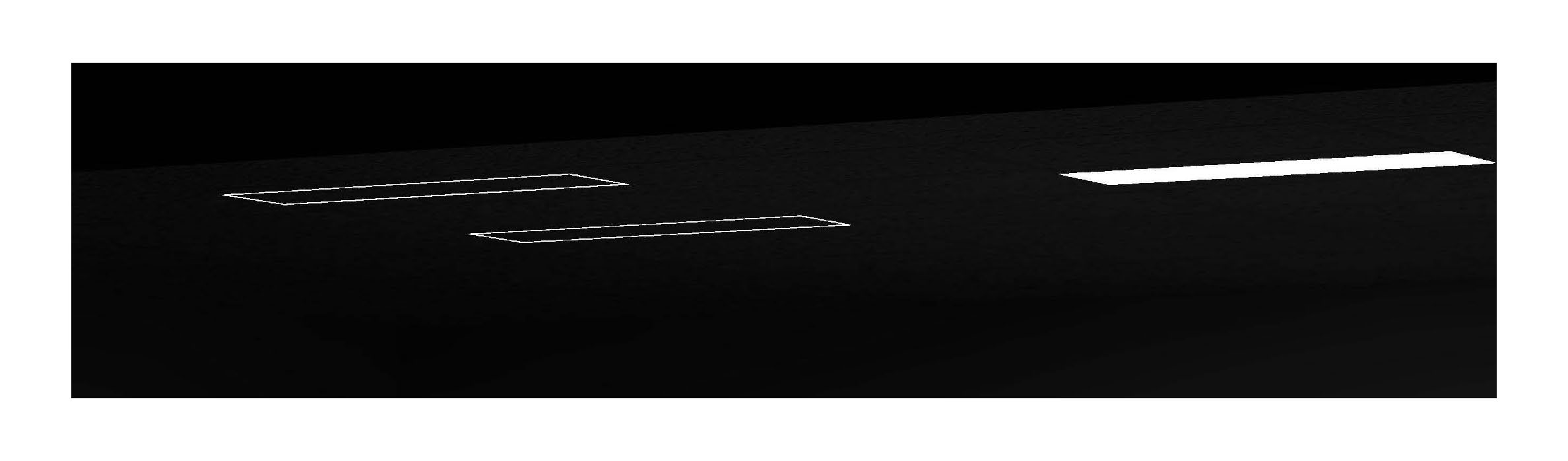

Problem 2: In the Generic Face-based template, the option to create an Opening is grayed out, so that when I do a rendering with these fixtures, the only thing that "glows" is the rectangular flange around the perimeter of the fixture, which sticks out just below the plane of the ceiling; the interior of this rectangle has the ceiling tile texture in it, and no light comes out of it. See the attached image to see what I mean.

Thanks for confirming that only the ceiling hosted template can cut through the ceiling. Unfotrunately this won't help the EE. I tried moving the light source down as you suggested and that was partially successful (see image- the two fixtures on the right). I believe what I have to do is create a "dummy" translucent plane at the face of the fixture, as that is what "glows" in the rendering. Of course then the diffuser won't look like the one in the actual fixture, which has multiple planes. But perhaps I can make this "dummy" diffuser invisible in all views. That might work...

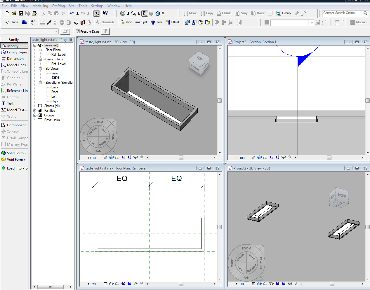

Why don't you create a "Void" (opening) in your family Face-Based? Also, in your family go to "Settings-Family Category and Parameters" and change to "Lighting Fixtures"...

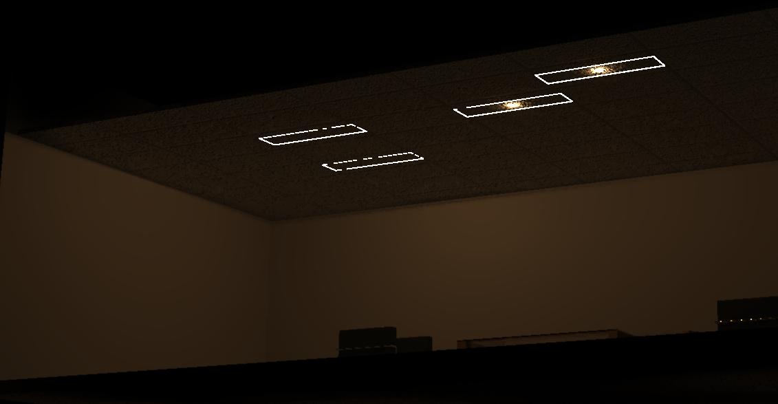

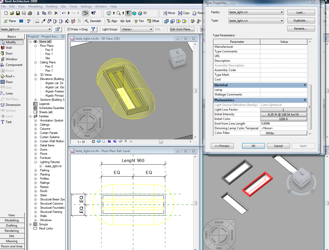

It also looks like you have used a single point for the light source, you should use a linear light source like in Typhoon's screen grab.

typhoon, I tried the void idea but the void doesn't cut through the ceiling geometry the way an "opening" in a ceiling-hosted family does, so I still got just a glowing rectangular band.
psymon, the light source type is indeed set to linear-  but I may have had a generic IES file attached to the family when I did that rendering, rather than the one that goes with the linear fixture, so that probably accounts for the spotlight effect.
