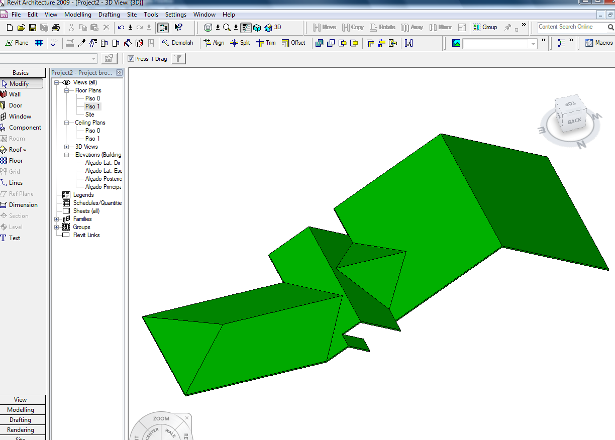

New to revit need help.  Any suggestions on how to make this roof/cricket work?
Thanks,
RLM

Hi, see the model i put to you download and check like you can do that, use also, the "Join/Unjoin Roof" command

Hi, see the videos: 1º video: http://screencast.com/t/BHkOFGzZ
                           2º video: http://screencast.com/t/3tQQUaF4p
Give me a feedback ok?

It works!  The videos were very helpful.
