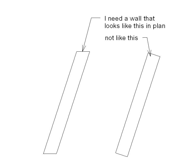

I am working on a project that incorporates some garden/landscaping walls.  I need the walll to have angled ends (as opposed to 90 degree ends).  Please view the attached image for further clarification.  Is there a way to accomplish this in Revit 2009?

Don't use standard walls.  Use an in-place family of the shape you need.  It can still be in the wall category and you can apply the finish to it taht you want.

Thanks!  That works perfectly!
