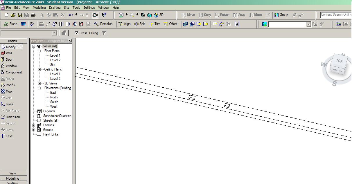

I am creating a beam that should have holes (voids) piercing every 3'. I've been studying a number of arrays in other families, and I've read the tutorial on nesting and arrays, but I can't figure this thing out!
 I tried to create a formula for the array, but the voids continue to lock to the center of the beam, and there are only two voids.

When arraying - use ' move to last' option. Otherwise your voids aren'l cutting any thing

Unfortunately, the revised attached that you gave only has two voids placed in the center of the beam when used in a project. Or, am I doing something wrong?
