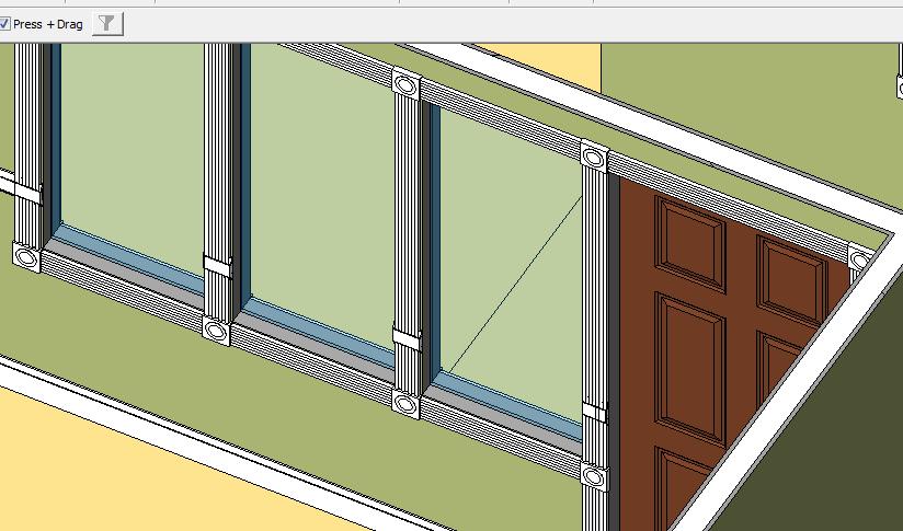

Is there a way to split or join a wall sweep?  For instance, I have a window that's broken up into three sections with fluted trim in between.  When I place my chair rail wall sweep on that wall, it shows up in the flutes because the openings stop at the edge of the window.  There are other instances where the wall I want a sweep on crosses several door ways for rooms that I don't want the sweep in.

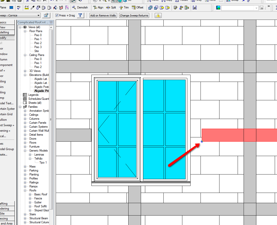

Hi, can you put some screenshots to figure exactly what really do you need?
You have that "blue dots" when you pick in the sweep and you can "Stretch" them to the position you want, you can "Join" them, use the "Join Geometry" command...

This wall is more doors and windows than wall.  I can stretch all the segments together on one end, but that's annoying.
