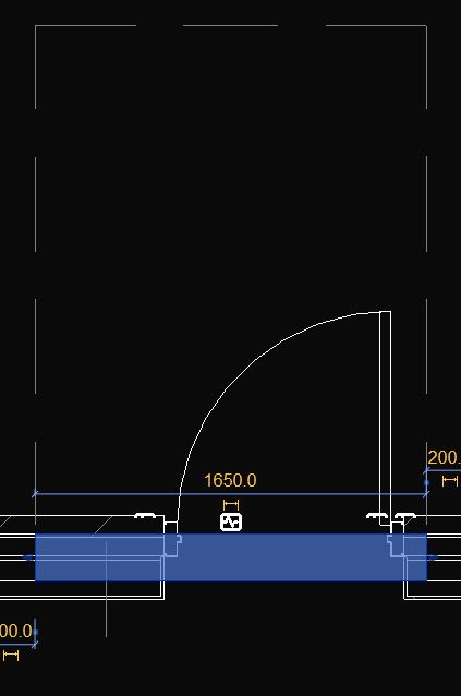

I am working in Revit 2015, still seeing this problem.
Our doors have symbolic lines added to denote clearances at the doors - 300-push side, 600-pull side, 100-at the jamb.  We find this to be a most valuable addition to our doors.  Unfortunately when our structural engineers copy/monitors our walls, the openings reflect the door + clearances.  ... see the attached image where I've highlighted the opening.
Has anyone got a solution?  other than removing these valuable design aids or forcing the Structural engineer to manually adjust all the copy/monitored openings??

Wed, Mar 23, 2016 at 10:01:28 AM | Copy/Monitor Openings
We have the ADA clearances in a seperate family as a detail family and we don't include it in the door family.
I would make a bet that if your linework was an embedded detail family, that it would not affect the opening.

WW,
Thanks for your response, but you'd lose the bet.  My clearance lines are symbolic lines within a nested family within the door families.  I am open to any suggestions ...
I have submitted this issue to Autodesk, perhaps they will offer insight as to why the Opening Cut does not govern the copy/monitored openings.

Thu, Mar 24, 2016 at 2:22:08 PM | Copy/Monitor Openings
You say symbollic linework in nested family.   That is NOT what I suggested.   I said NESTED DETAIL FAMILY!  There is a big difference.  I don't have time to test now.

sadly, no difference.

I havent tested this but have you tried changing all the symbolic lines to 'not a reference'. when you forst draw them they default to 'weak reference'
