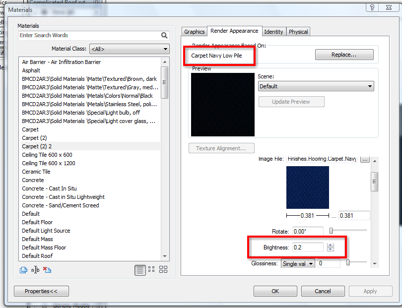

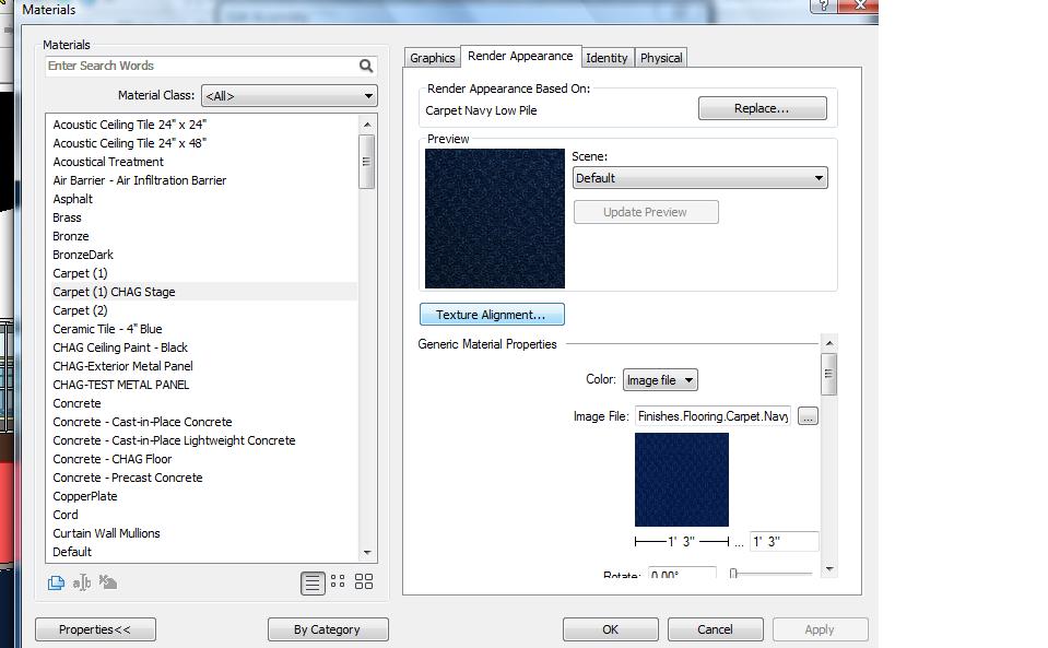

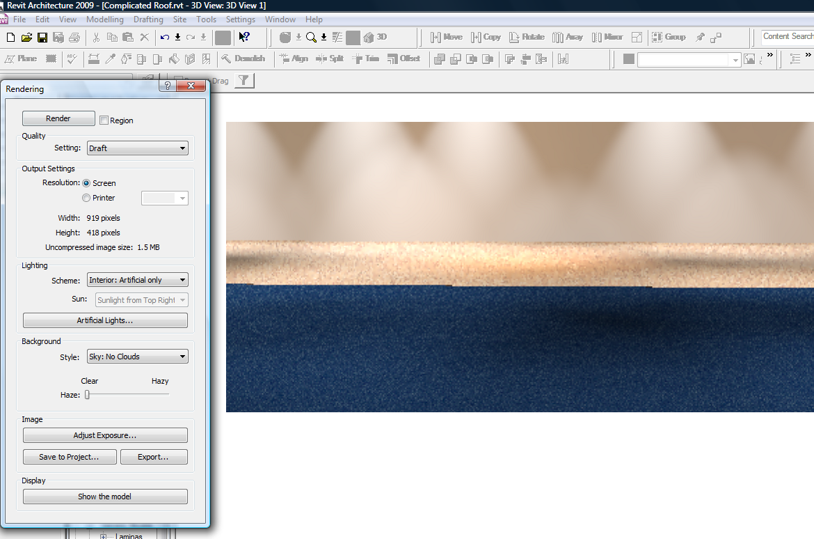

It is Revit Arch 2009, I figured out why they were not showing up.  The lights being used were recessed cans, and they were recessing into the roof that have, so there was no light coming through the roof.  But now that I have light another issue has come up.  When rendering an interior, the carpet turns out way brighter under the lights than it looks when I select the color.  Here are some shots.  The color in the dialog box is a lot darker than the color in the render. ???

Hi, change the "Brightness" value...
