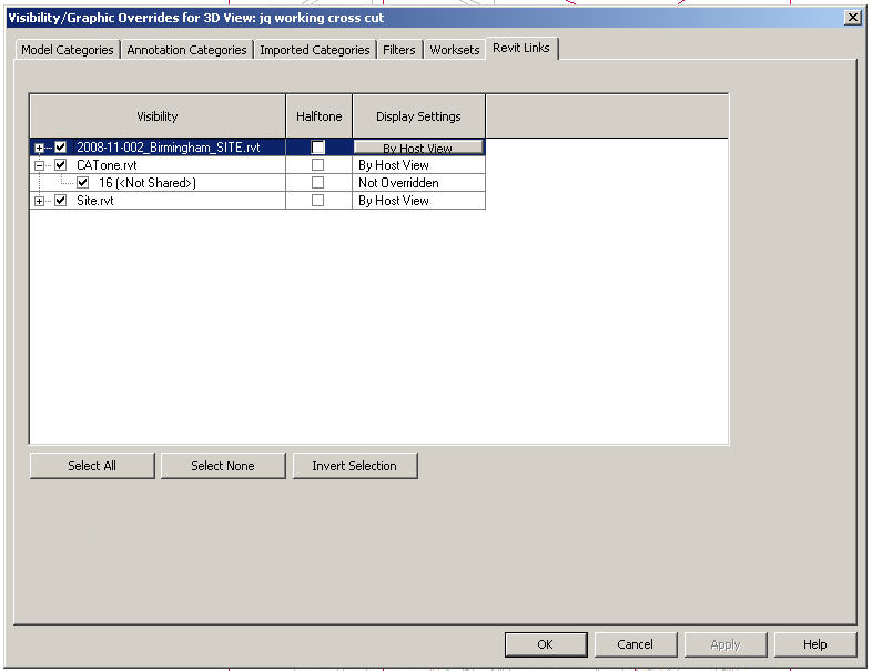

can anyone explain why when a linked revit file come sin there is a "not shared" link of it underneath it? refer to pic attached.

The not shared refers to Shared Coordinates. It looks like you might have the linked revit model placed 2 times in the file.
