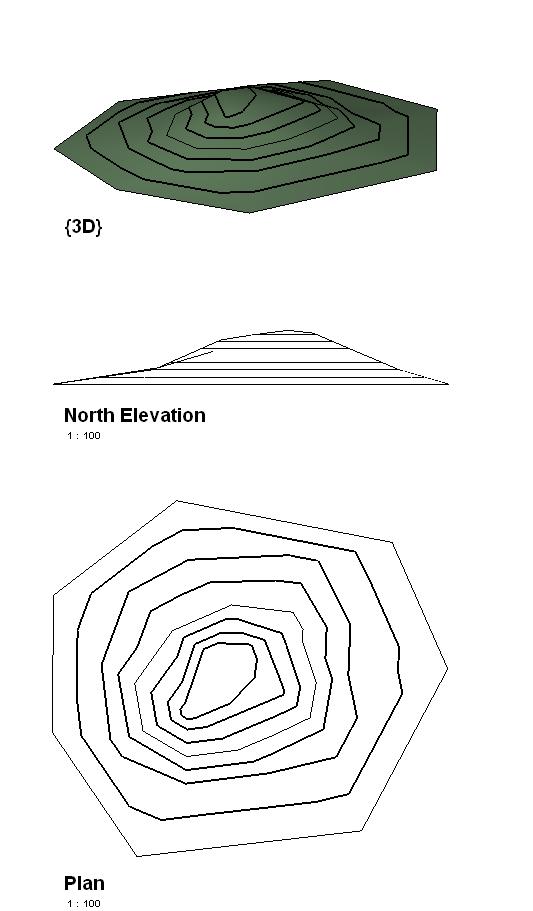

Have you done the tutorials on topo surfaces, once you've done those you'll have no problems making a small hill.
Just create a toposurface by points and incrementally change the elevation height, you can edit in 3d and elevation views aswell until you get what you are after.

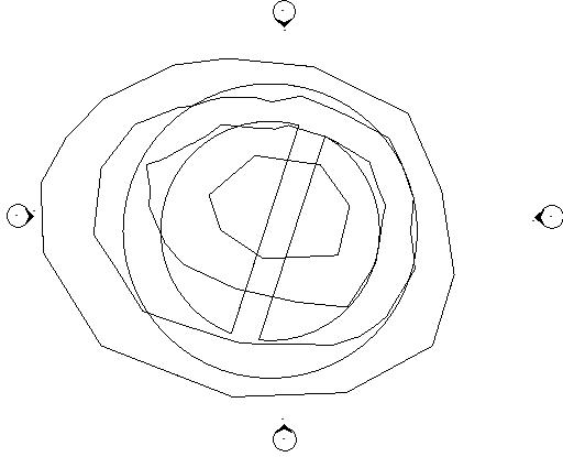

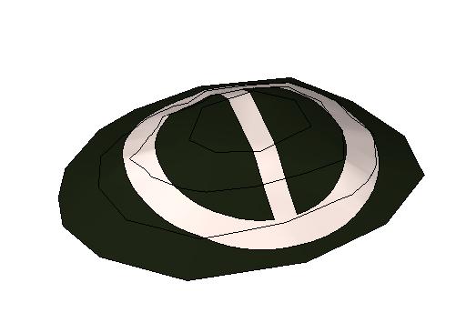

Yup, Teddy is right, you can read the tutorial about toposurface.. you can create contour using point or you can import dwg or csv file to Revit... and for driveway along the contour, you can create it with subregion... but, there's a good thread here about toposurface, but I forgot where it is... :D
