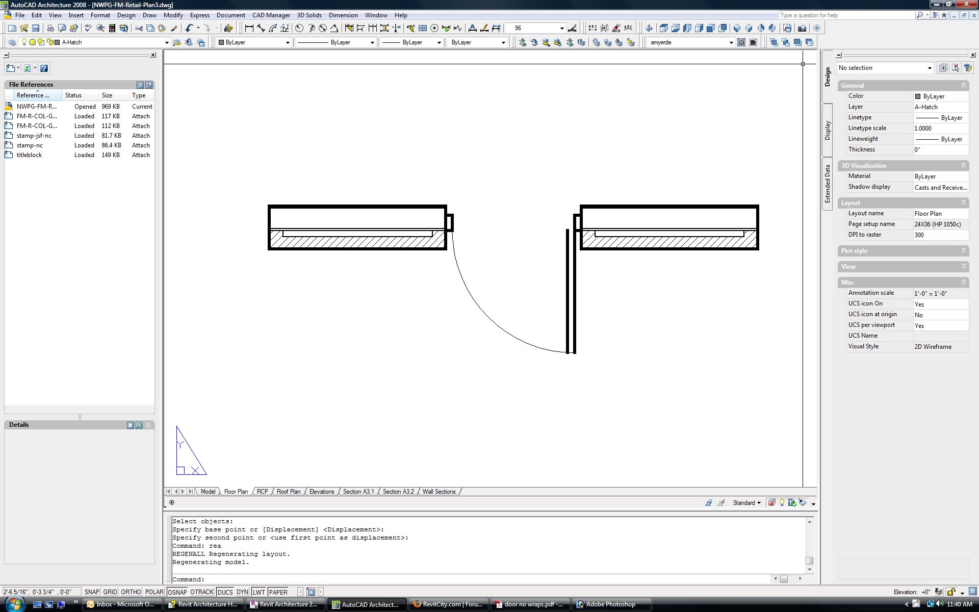

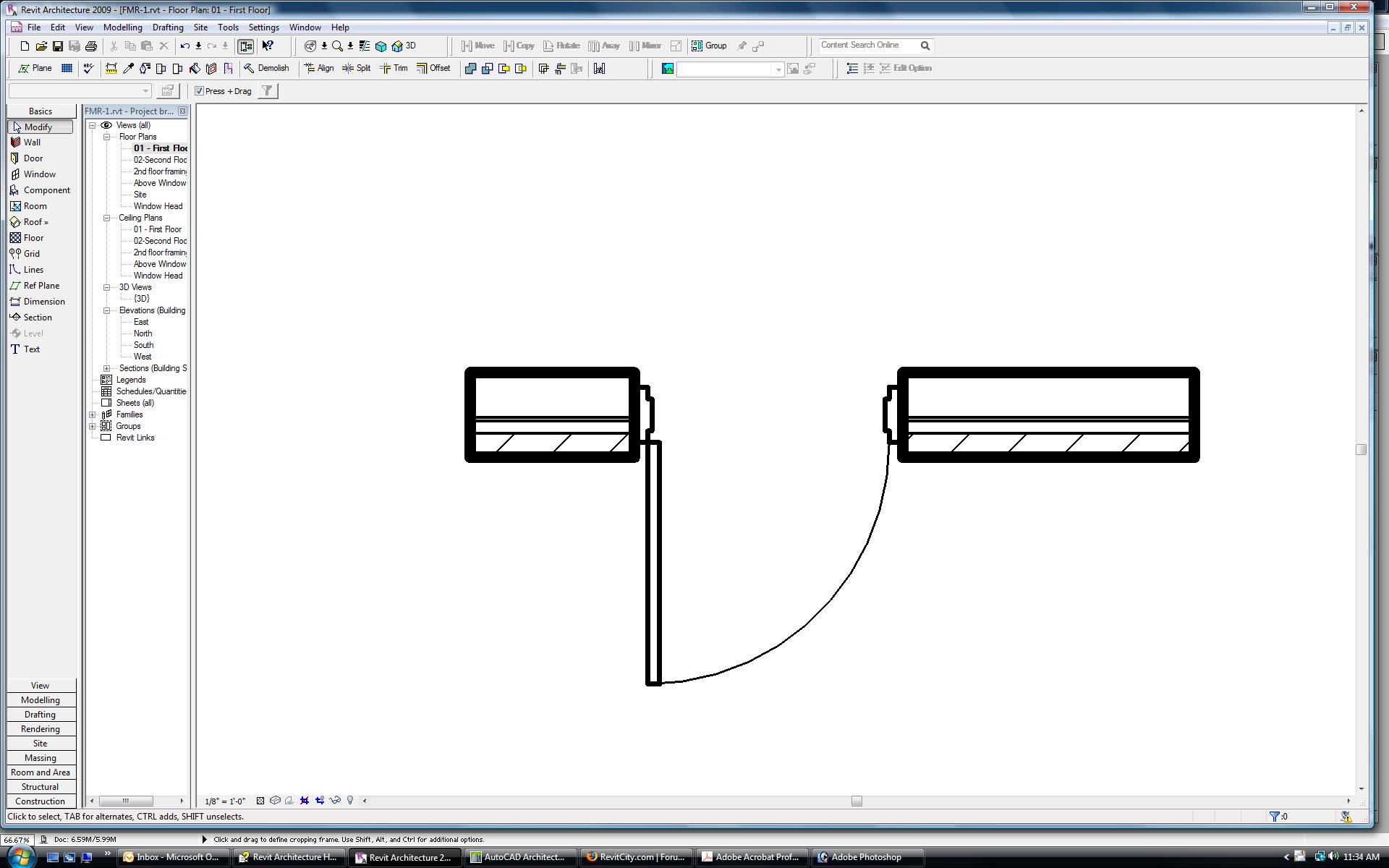

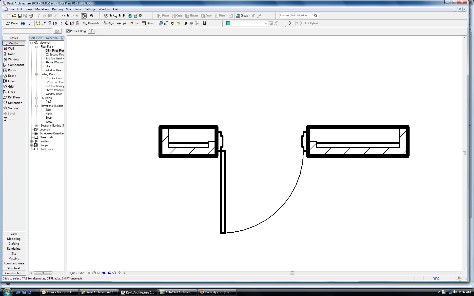

I need help manipulating wall wraps.  I'd like the exterior material (let's say brick) to wrap in and stop at the face of the exterior sheathing.  Instead, Revit wants to take it to the center of the wall structure and does not seem to give me any means to adjust that.  I have attached 3 jpeg immages.
1 is a cavity wall with no wraps (Revit)
2 is a cavity wall with exterior wraps(Revit)
3 is a cavity wall drawn in AutoCAD which looks exactly like what I want.
How can I get Revit to draw it correctly, like we always have in AutoCAD?

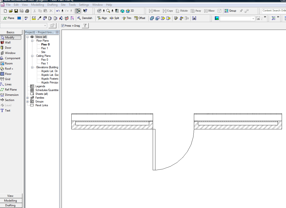

Something like this: see image attached

Yes, but yours still cuts into the exterior sheathing a little bit.
How can you control that?

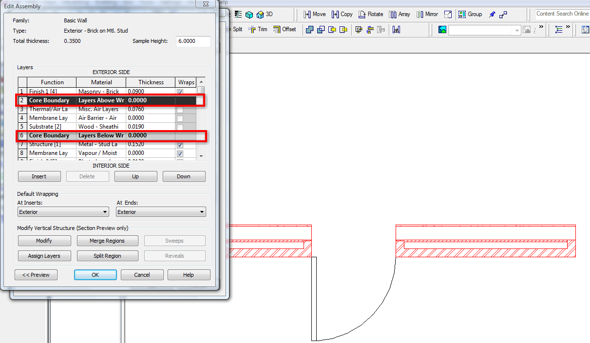

With the "CORE"... I hope this solve the problem...

I tried your solution but found no real difference.  I can achieve the same thing by simply adding an inch to my air space.  It seems to want to return the brick exactly 2.666" regardless of how it is defined.  Try deleting an inch from your air space and see what result you get.

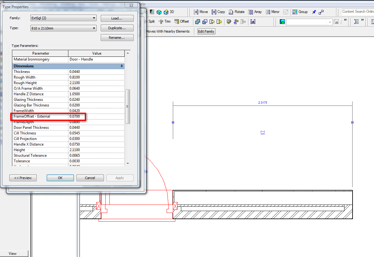

Also, once I get this one solved my next problem is to figure out how to adjust where the door and frame sit within the wall system.  The door frame needs to be framed within the stud wall width, not the veneer.  AutoDESK allows you to shift the location of the door within the wall system depth but I have not found that here yet.
Wed, Oct 15, 2008 at 2:15:51 PM | Wall Wraps
Joined: Tue, May 22, 2007
5921 Posts
4 Stars: 205 Votes
Well i think it works fine, about the door you can control the frame position in the properties of the door in "FrameOffset-External" and you have the others parameters to control the rest of the door...
