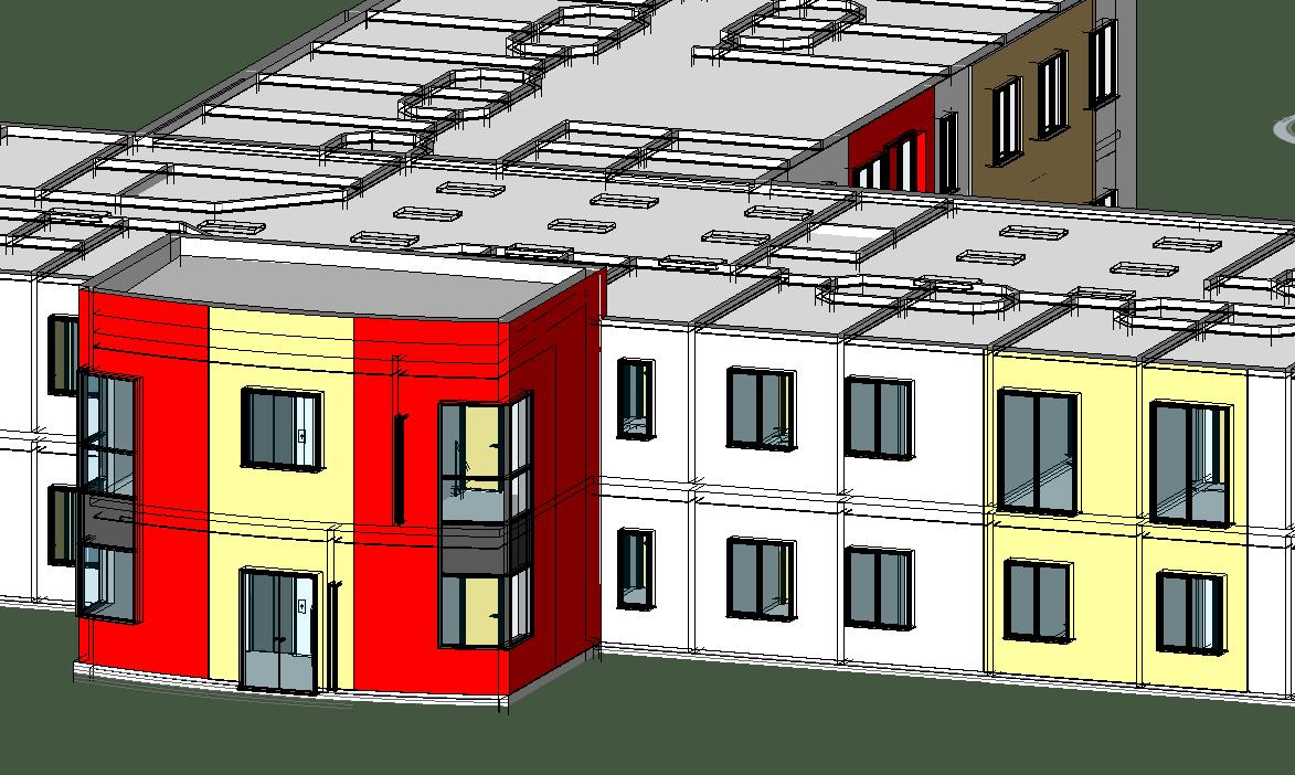

right in my 3D view of my model i have the model graphics set as shaded with edges and yet my building still looks slightly wireframe and sketchy! i dont know what i have done to make it like this but its annoying because there lines everywhere which are quite confusing! i have attatched a jpeh showing what i mean Smile
anyone help me with this!?

Hi, delete that 3D view and create a new one, this solve the problem, by the way, what graphic card do you have???

thank you very much :o) thats worked spot on!
