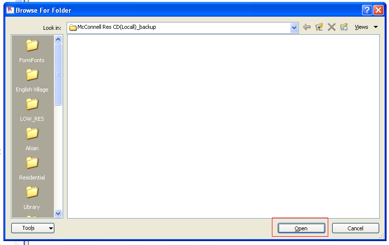

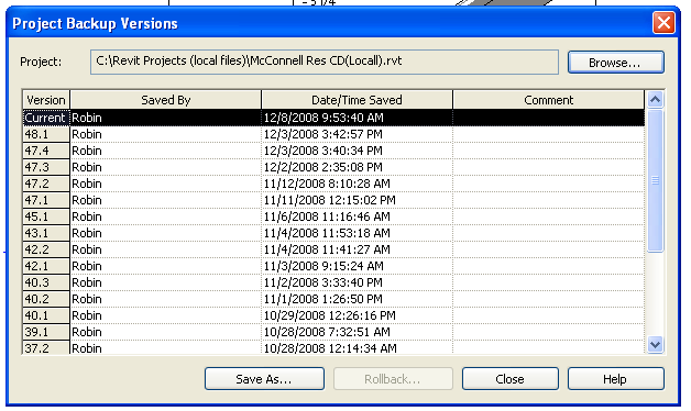

I would open the Local file you want to find backups for. Goto File/Backups.. browse to the back up file and click "open" it is not looking for you to find a file. Just the location. When you click "open" it will show the dates that are available. See attached images.

#14
lorne17
lorne17 Avatar
Joined: Wed, Aug 29, 2007
417 Posts
3.5 Stars: 7 Votes
wow, what an oversight.  Thank you for your help.
