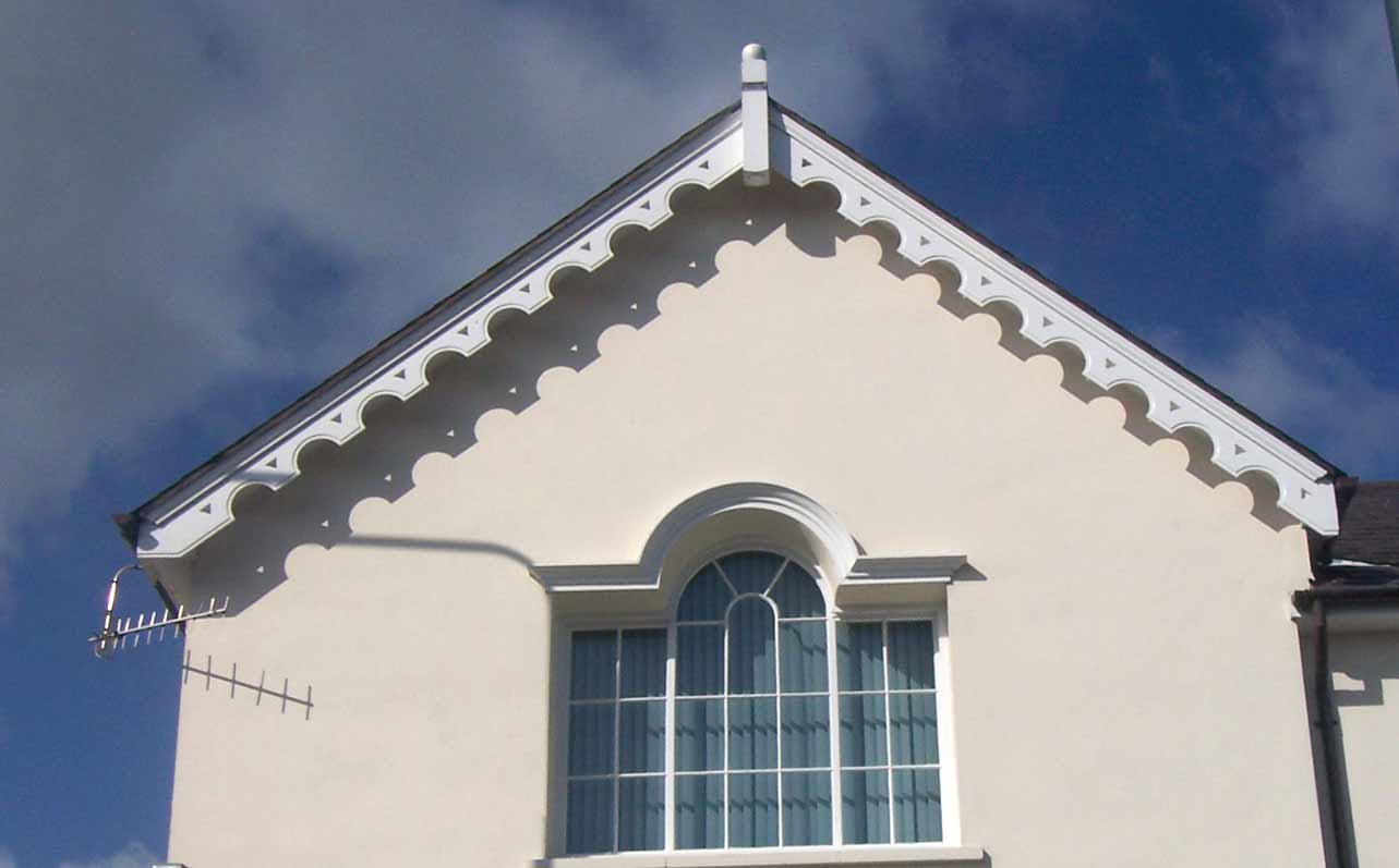

I attach a photo of what I am trying to achieve. My client want the barge boards of an extension to be scalloped. Perhaps not similair to the photo but same principal. I know that to get a fascia or barge board you go to  Modelling, Host sweep and then roof fascia. But this gives a rectangular uniform shape. I have scratched my head till it hurts. Any idea anyone?

Sorry for the (extremely) late reply, but it looks to me like that will have to be a homespun generic model family.  Proper use of parameters can get you a fascia that can be modified in all axes while maintaining a pattern like that.  The basics can be found here:
http://www.revitzone.com/index.php?option=com_content&task=view&id=692&Itemid=34
