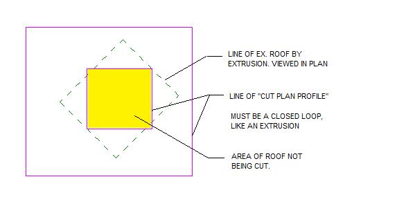

The "Cut Plan Profile" tool works by defining the are to be Cut. The area to be cut needs to be a closed loop. Much like your standard sketch mode for floors or roofs. CryingSee Attached Image)
