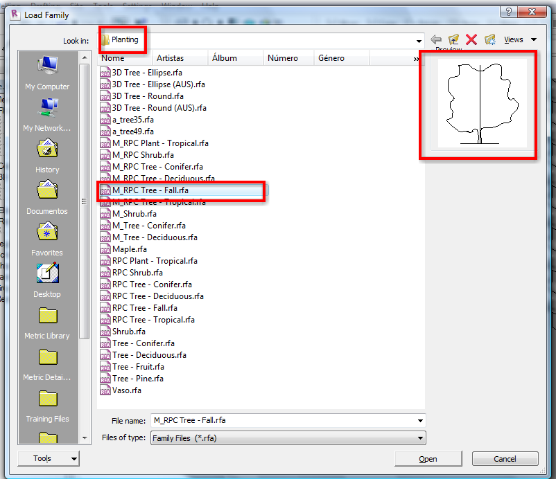

I cant get Revit Structure to render a tree- I checked the visibility option (vv) and nothing happens... can anyone halp? I see the tree before rendering in 3D view, but whwn it starts to render, it disappears

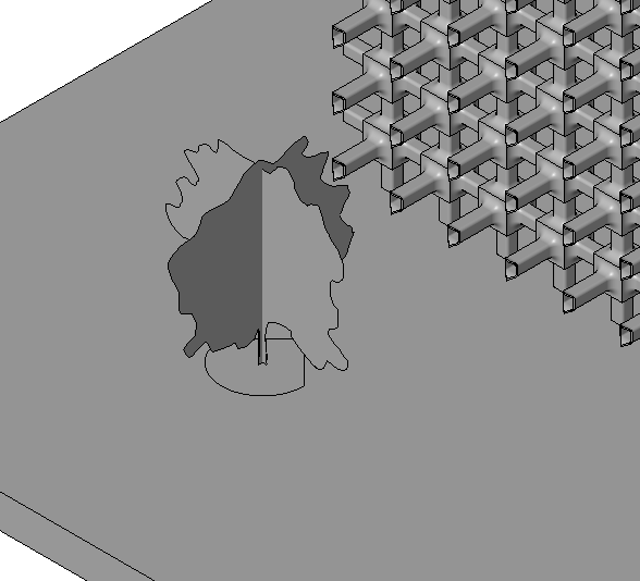

Hi, when you pick in "Components" go to "Load" and in folder "Planting" (see Image 1) you can choose the Tree you want and then the aspect in 3d view is like in image 2 attached...

thanks, it worked!
