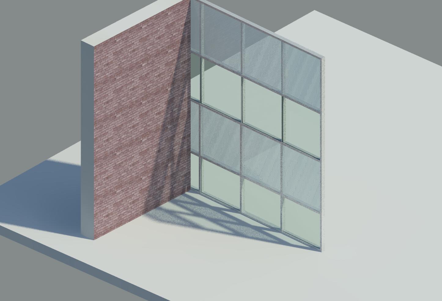

Hi,
How do you put a pattern as an interlayer in the glass?  AKA silk screen or fritted glass?
basically I am trying to create laminated glass with a pattern sandwich in between 2 layers of 1/4" glass.
I tried decals, but couldn't get it to work.
the other way I can think of is actually model the laminated glass.
anyone got any idea?
Mon, Oct 13, 2008 at 3:27:21 PM | Rendering glass with pattern 2009
mthurnauer
Joined: Mon, Dec 17, 2007
83 Posts
3 Stars: 2 Votes
I did a quick test. It looks like a good start is to duplicate the default Glass Block material in Revit and then make your own image map for transparency and you can probably just delete the bump map.  I cannot tell in my test renderin if it is applying the frit to both the front face and the back face.
