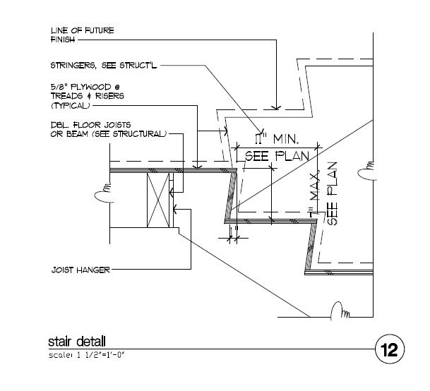

Anyone who can tell me how to build the stair use Revit as the image?
The risers type of the stair are slanted.

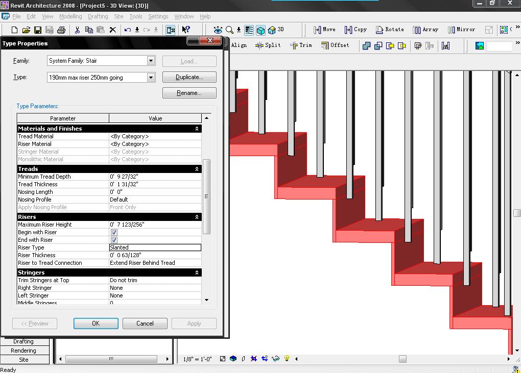

Yes,i can find it.But when i choose the slanted,all the risers are missed.

"But when i choose the slanted,all the risers are missed." ??? What version of Revit are you working? can you put some images of that stair in 3D view With the stairs Properties menu Open?

I used Revit Architecture 2008,following is the image.

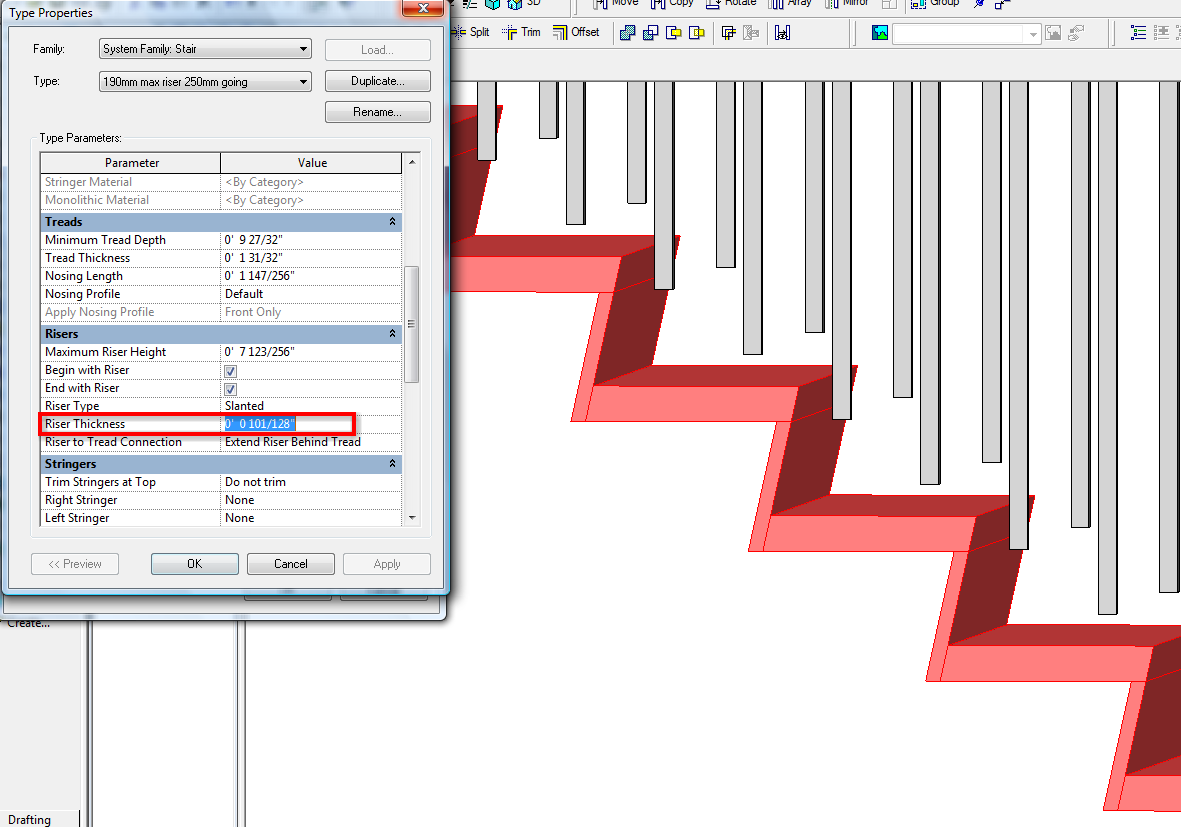

Hi, sorry for the delay, you must change the Riser Thickness like you can see in the image then it work...

Is it the Riser thickness or the Nosing Length? I think the Nosing Length will determine the Slant.

Thank you,Typhoon and robinballew.
The important point is Nosing Length as robinballew said.
Thank you very much robinballew!
